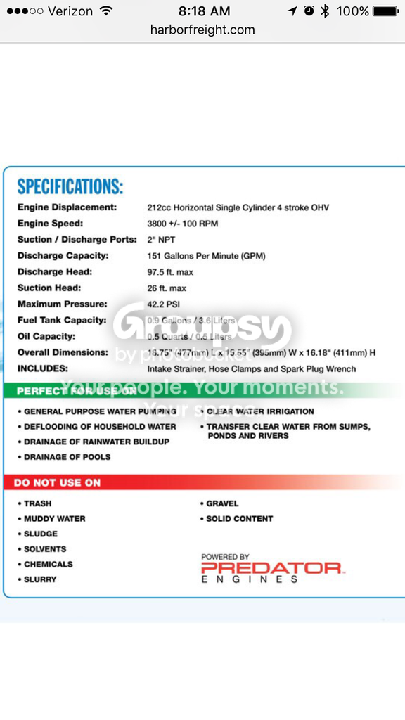

Also the pump pressure capacity you have is 42.2 PSI which is just shy of 3 bar ( I have 4 bar at my kitchen tap ) which equates to 30 meters or 98 feet head ... so you are not going to have great sucking capacity unless you upgrade the pump on your moto ... understanding that centrifugal pumps have restrictions and also tolerances in design in reference to particle size they allow through the pump which a/effects the pressure capacity ...
