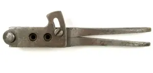

It is definitely a civil war era Colt .44 bulletmold for casting the "New-Model" of Colt revolver bullets. See photo below showing the specific version of .44 bullet your mold would make.
Something unusual about your bulletmold is that it never had the "sprue-cutter" which was attached to bulletmolds manufactured by the Colt company. The handles are shaped differently than on the Colt-made mold. Also, the holes for pouring lead into the mold are crude irregular openings, instead of neatly circular like on the Colt Company's version. See the other photo below (which includes Colt's patent-marking). Those three differences make me wonder whether your bulletmold might be a Confederate imitation of Colt's mold.

  • bulletmold_44ColtPatent_1850s_with-sprue-cutter_topview_TN_postedbyBosnMate.webp
It looks like the sprue cutter was broken off. The hole for the screw is still there.
I noticed that the hole for the sprue cutter's slide-screw is there. But the sideview photo of the mold shows there isn't any room for the sprue cutter at the top of the mold's hinge pin. However, the hinge-pin's "head" looks crudely formed. Perhaps the original hinge-pin broke, and was crudely replaced, leaving off the sprue cutter.
