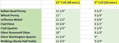

Based on requests from several folks who are curious, I went ahead and did some air testing with my new Minelab 6” coil, attached to my Equinox 800. I wanted to give folks some idea of the relative capabilities of this coil as compared to the 11” coil.
While all the normal caveats of air testing apply — such as, air-test results in no way mirror in-ground results, etc. etc. etc., I do think there is at least a little bit of value when doing side-by-side air testing of two different coils for comparison purposes. Anyway, how much value exists in such a test is up to each individual to decide; I simply wanted to provide the data. I also did a YouTube video, which I will post a link to as soon as it is done uploading. In the video, I did NOT record the testing of all the coins; I ran only the silver Roosevelt dime in the video to show you, audibly, what quality of signal I listened for in order to call it a “hit.” In other words, how repeatable of a signal I listened for before I assigned a depth value to that particular coin, with that particular coil. The rest of the video is just some discussion of a few points regarding the coil, and the testing.
Anyway, here is the data…
Minelab Equinox 800
11” and 6” coils, air-test comparison, done indoors
Park 1 Mode
Sensitivity 18
Noise Cancel Channel 7
All-metal mode (horseshoe button engaged)
Ground Balance 0
Recovery Speed 4 (on the 800, equivalent to 2 on the 600)
Iron Bias 2 (on the 800, equivalent to 1 on the 600)
Here are the results:
After this “apples to apples” comparison, where I tested both coils using identical settings, I then re-tested a couple of coins (specifically the silver dime and the silver quarter) on the 6” coil, but this time bumping sensitivity to 22. I found that I was able to run sensitivity about 3 points higher, as the 6” coil is (as expected) less affected by EMI. Since “18” is a rather conservative sensitivity for a 6” coil (but that is as high as I could go with the 11” in my indoor testing, and I wanted to keep it “apples to apples”), I wanted to see how much depth gain I would get on the 6” coil if I bumped sensitivity up some.
Here are those results:
In summary, you can see that the 6” coil (at 18 sensitivity) loses roughly 1 ¾” depth on each coin, in an air test, as compared to the 11” coil. You can also see that by bumping the sensitivity on the 6” coil up from 18 to 22, you “gain back” most of the loss of air-test depth, getting to within ½” to ¾” of depths achieved by the 11”coil, set at 18 sensitivity. SO…while you DO lose depth with the 6” coil, as expected, you may — in a real-world scenario — be able to gain most of that depth back, due to being able to run it at a higher sensitivity setting. Overall, I am thus far impressed with the coil, and can’t wait to use it “in the field,” where I can begin to get a feel for its REAL value — its ability to separate, in trashy sites.

Hello all!
Based on requests from several folks who are curious, I wentahead and did some air testing with my new Minelab 6” coil, attached to myEquinox 800. I wanted to give folks someidea of the relative capabilities of this coil as compared to the 11” coil.
While all the normal caveats of air testing apply – such asair-test results in no way mirror in-ground results, etc. etc. etc., I do thinkthere is at least a little bit of value when doing side-by-side air testing oftwo different coils for comparison purposes. Anyway, how much value exists in such a test is up to each individual todecide; I simply wanted to provide the data. I also did a Youtube video, which I will post a link to as soon as it isdone uploading. In the video, I did NOTrecord the testing of all the coins; I ran only the silver Roosevelt dime inthe video to show you, audibly, what quality of signal I listened for in orderto call it a “hit.” In other words, howrepeatable of a signal I listened for before I assigned a depth value to thatparticular coin, with that particular coil. The rest of the video is just some discussion of a few points regardingthe coil, and the testing.
Minelab Equinox 800
Park 1 Mode
Sensitivity18
Noise CancelChannel 7
All-metalmode (horseshoe button engaged)
GroundBalance 0
RecoverySpeed 4 (on the 800, equivalent to 2 on the 600)
Iron Bias 2(on the 800, equivalent to 1 on the 600)
View attachment 1625494[SUB][/SUB]
After this“apples to apples” comparison, where I tested both coils using identicalsettings, I then re-tested a couple of coins (specifically the silver dime andthe silver quarter) on the 6” coil, but this time bumping sensitivity to22. I found that I was able to runsensitivity about 3 points higher, as the 6” coil is (as expected) lessaffected by EMI. And since “18” is arather conservative sensitivity for a 6” coil, but that is as high as I couldgo with the 11” in my indoor testing, and since I wanted to keep it “apples toapples,” I wanted to see how much depth gain I would get on the 6” coil if Ibumped sensitivity up some.
View attachment 1625495[SUB][/SUB]
In summary,you can see that the 6” coil (at 18 sensitivity) loses roughly 1 ¾” depth oneach coin, in an air test, as compared to the 11” coil. You can also see that by bumping thesensitivity on the 6” coil up from 18 to 22, you “gain back” most of the lossof air-test depth, getting to within ½” to ¾” of depths achieved by the 11”coil, set at 18 sensitivity. SO…whileyou DO lose depth with the 6” coil, as expected, you may – in a real-worldscenario – be able to gain most of that depth back, due to being able to runit at a higher sensitivity setting. Overall, I am thus far impressed with thecoil, and can’t wait to use it “in the field,” where I can begin to get a feelfor its REAL value – its ability to separate, in trashy sites.

Steve first I want to thank you for taking the time to do the air test. That’s very useful information you’ve provided to all us Equinox users. I think I may just leave the 6” coil on all the time and crank up the sensitivity alittle. I mostly beach hunt and I don’t need to dig deep holes for resent ring and coin drops on a beach. Thanks.
Hawks -- you are quite welcome! I know alot of EQ users have been curious, so if some of this helps, I'm glad!
It does seem that cranking up the sensitivity on the 6" will allow it to achieve really good depth...
