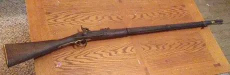

Apparently gun forums require a period of time before you can post threads so I am reaching out here. Any help greatly appreciated 71602787255000.webp51602787254000.webp11602787254000.webp01602787254000.webp
To be honest it looks like one of the rifles that came out of the Nepal Horde, that IMA (International Military Antiques) was/is selling. From a quick look on my cell phone, it looks like an Enfield P1853 (Muzzleloader) 3 Band Rifle. If in fact it's from the Nepal Horde, it could be an British made one, Nepalese made one, or combo of parts from both. I base the Nepal origins on the Devanagari or Sanskrit writing on it.
The 3 band term comes from it having 3 barrel bands, the shorter model has 2 and therefore is referred to as a 2 band Enfield.
Any background on the rifle? Where did you get it from?

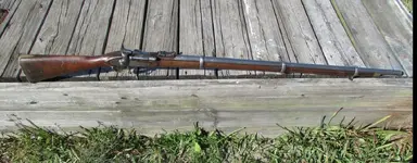

Here's my P1853, updated from Muzzleloader to Breech Loader with the Snider-Enfield system. So you can compare the similarities (Just ignore the compartment on the breech end).
Looked at the pictures again and I'm not seeing any markings on the lockplate, unless it's under the grim. With that I'm leaning towards Nepal made copy of the P1853 Enfield.
These rifles came out of Nepal covered/coated/caked/encased (Pick your word) in crud that accumulated over a period of many years.

I would recommend a total disassembly, inspection, cleaning and oiling of the weapon. For broken or missing parts, you can order them, but you'll have to do some hand fitting.
If you wish to shoot it, have a reputable gunsmith check and verify the barrel is safe, if good to go, do some light loads and let her belch smoke and fire.
ffuries got it!
Agree with the Nepalese connection based on the writing on the tang.
Great ID. Once you clean off the yak fat and dust, you'll find more markings. It is likely a relic from the Sepoy Rebellion of 1857 - India's first organized attempt to gain independence, put down by the British. At the end, many Sepoys escaped to Nepal where they were disarmed at the boarder.

Your markings are for the Devidutta Battalion Section 2 Number 15.

Thanks for the decipher/translation assist there. I was exhausted last night and couldn't focus on the script. So I was going to try and do it today......
yep Nepalese Enfield, I have one on my wall and another one in pieces in my shop. If you email pics of the markings to John Walter he will translate them for you. He wrote a book about them and is always interested in seeing new markings to add to his database johndouglaswalter@gmail.com

Just came back to this post....ffuries said to have the barrel checked if you want to shoot it, and that's extremely important. before you have anyone look at it take the barrel out of the stock and check for pitting on the bottom, if there's deep rust pits it's probably not safe. But it's also important to check the stock for cracks, especially behind the barrel and check the fit of the barrel bands, if they are loose I wouldn't recommend shooting it. if everything is tight, and the lock works, (I had to do some work on mine to get the sear to engage correctly) then it's worth having the inside of the barrel looked at to see if it's safe to load and fire, but if it has obvious problems it's probably best to save your money and just hang it on the wall

Couldn't agree more with NOLA_Ken here. That said, if banished to Wall Hanger status, give it a good cleaning, oiling etc so it looks better and preserves it.
