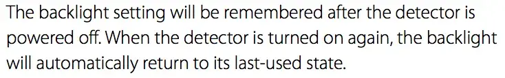

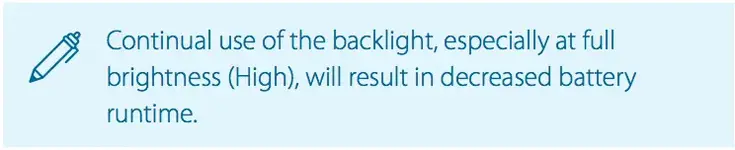

Screen Shot 2018-05-19 at 10.05.54 PM.webp​
sometimes this is the cause of my short runtimes....

I havent been using the back light at all. Sensitivity has been around 20 and volume at 24.

Make sure that you do not have the backlight on by mistake !! Look for indicator on screen
As mentioned before i dont have the backlight on. No symbol and no illumination. The detector went to 1 bar of power after 3 hours or less. Then sat at the one bar for the remaining 3 hours.
