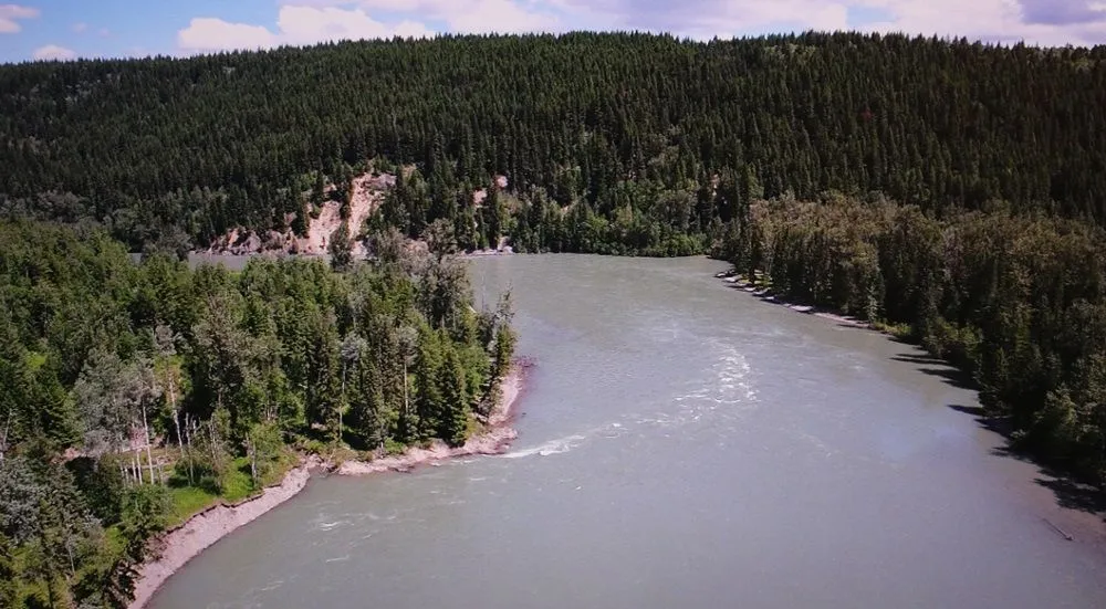

Season is going very well. On the new claim at low water we managed to find some decent gold flakes. The bed rock that was exposed is now under water and will have to wait until late summer / fall to work that. Attached is a picture that shows why the river takes a sharp right angle as the bed rock extends half way across the river. Also a good guide as to the path the gold should take...
Hope you heal soon to start chasing that sassy yellow stuff again.....

Originally Posted by Cariboo5 Bummer...........Here's hoping for a speedy recovery for you...
Thanks, but I'm especially sad about probably not being able to head to the far north of B.C. to nugget shoot this summer.
"Drop a note and some pictures here every once in a while, if you get the time, to let me know how your season is going.
All the best,"
Lanny
Thanks for the update and the picture on your prospecting adventures.
It's nice to see what you're up to, and I agree, you'll need to wait a bit before you're able to capture some of that gold that drives so many of us to such remote and scenic locations.
As for that trail of white water that signals what's going on below the surface, those trees that are anchored in that jut of forest, or the bottom end of it, sure could be holding some flakes of gold; moreover, if there's coarse gold around, some sassy nuggets dropped by a high-water event, but I imagine you've already tested a bit of that dirt through some panning. Perhaps that's where some of those flakes came from.
