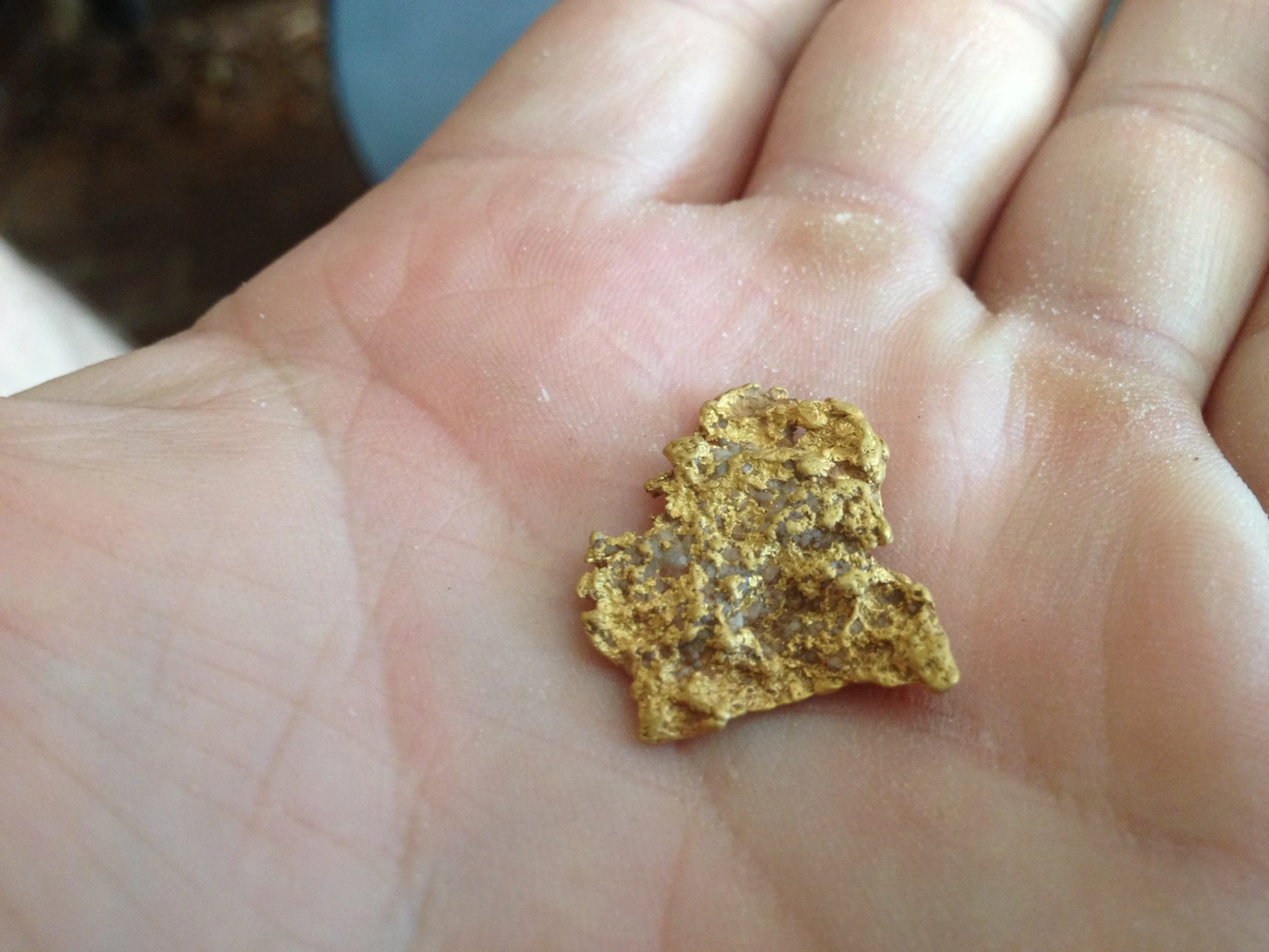

Here is an example.
The nugget below was found laying nearly on the bedrock surface on an open slope about 10' below an area that showed evidence of recently being worked over hard (broken brush and raked tailings).
It was on unclaimed public ground, that had been ground sluiced.
I think many people get tunnel vision and focus in on the area where they find their first nugget rather than stepping back and calmly surveying the area to get a broad perspective...how did the gold get here and where is it slowly going. Downhill is always a good place to look. Gold is a follower...there is always one more piece ahead of it.
I think many people skip doing the broad search that would get the easy gold, instead they immediately begin raking through tailings or working a piece of bedrock. They get physically tired and move on to another spot if they don't find something fairly quickly. When I find a piece of gold, I always take a break and think about things before taking action.
When I first started nugget hunting, I would find a nugget, do a search of the area and move on if I didn't anything. Now I know that a single nugget can be a clue. Ignore it and you will miss out on much more.
