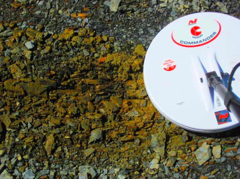

Nugget in the bedrock tip:
I had a visit with a mining buddy this past weekend, and he told me of an epic battle to get a nugget out of the bedrock, and of what he learned from the experience. I thought some of you might like to learn from his mistake.
While out detecting one day, he came across a large sheet of bare bedrock. The bedrock was exposed because the area had been blasted off with a water cannon (a monitor), by the old-timers! It was not fractured bedrock, in fact it was totally smooth.
He was not optimistic at all of the prospects of a nugget. But, for some reason (we've all been there) he decided to swing his detector over that bedrock. After a long time, just as he was about to give up on his crazy hunch, he got a signal, right out of that smooth bedrock.
There was no crevice, no sign of a crevice, nada! So, he had to go all the way back to camp to get a small sledge and a chisel. The signal in the rock intrigued him, but he still wasn't overly optimistic. For those of you that have chased signals in a similar situation, sometimes there's a patch of hot mineralization in the bedrock that sounds off, but this spot, according to him, was sharp and clear right in the middle of the signal, not just a general increase of the threshold like you get when you pass over a hot spot in the bedrock.
Anyway, he made it back to the spot and started to chisel his way into the bedrock. If any of you have tried this, it's an awful job, and you usually wind up with cut knuckles--at the least! Regardless, he kept fighting his way down, busting out chunks of bedrock. He kept checking the hole, and the signal remained very strong.
This only puzzled him all the more as he could clearly see that it was solid bedrock with no sign of any crevice. He finally quit at the end of the day, at a depth of about a foot, but still, nothing in the hole.
An experienced nugget shooting friend dropped by the next morning to see him, and asked him how the hunt was going. My buddy related his tale of the mysterious hole in the bedrock, and told the friend to go over and check it out, and see if he could solve the riddle.
Later in the day, the other nugget hunter returned. In his hand was a fine, fat, sassy nugget. It weighed in at about an ounce and a quarter! After my friend returned his eyeballs to their sockets and zapped his heart to start it again, he asked where the nugget had come from.
Imagine his surprise when he heard it came from the mystery hole!! He asked how deep the other guy had gone into the bedrock to get it. "Well, no deeper" was his reply.
So, here's the rest of the story as to what happened. When the successful nugget hunter got to the bedrock, he scanned the surface got the same strong signal as my buddy. He widened out the hole and scanned again. Still a solid tone. He widened the hole some more so he could get his coil in, and here's the key and the lesson in this story, he got a strong signal off the side of the hole, about six inches down, but set back another inch into the side of the bedrock!!
My unlucky friend, the true discoverer of the gorgeous nugget's resting place had gone deep past the signal while digging his hole!!
Now, of course, a good pinpointer would easily solve this problem. The problem was, my buddy didn't have one, so why would he widen the hole, right? Well, the other guy was the one with more experience, and that's why he did. It was a lot more work, but what a payoff!
So, my buddy's butt is still black and blue from where he kicked himself for the next week or so for having lost such an incredible prize.
Some nugget hunting lessons are harder than others to learn. . . .

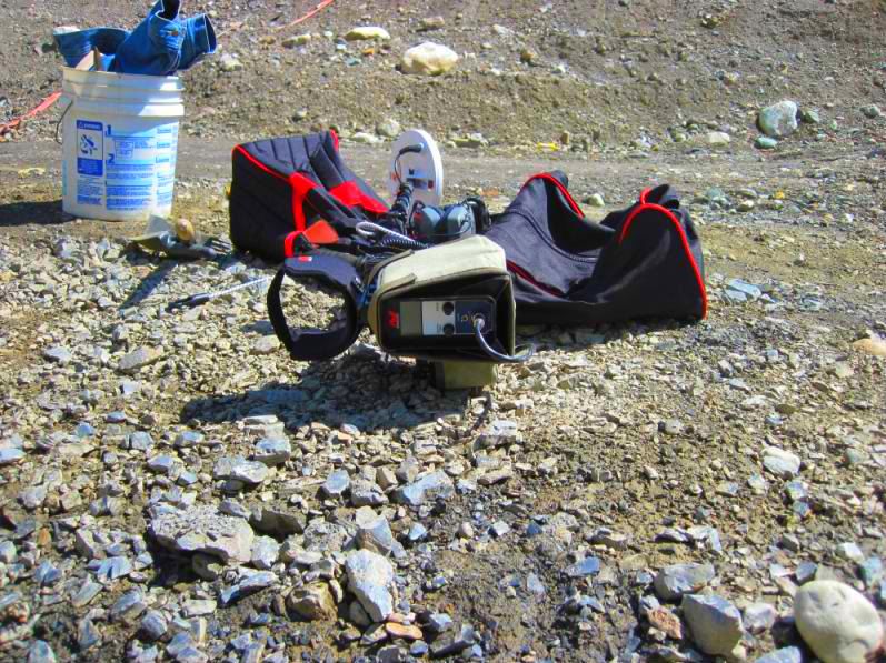

Squirrel Follow-up Gold
As I was setting up to detect the next week, one of the mine partners came down to the excavation to see me. He told me the best gold ran along the main drift-mine’s bedrock cut, found inside an area resembling a roughly shaped, reversed L. However, he wanted me to check the entire placer pit to see how well his crew had stripped for pay, and if they’d cut deeply enough into the softer bedrock.
I was welcome to keep anything I found. All I had to do was let him know where I found it and how much I found.
I quickly assembled the GPX 5000. The wind slashed terribly through the pit. It even rolled the detector bag across the bedrock toward a small bedrock pond, but the bag suddenly lodged in a low cut recently pumped dry. Even my five-gallon bucket of sniping tools took a header. That wind was trouble. Another trouble-maker was the heavy equipment operating upstream, throwing off EMI, and I didn’t know how well the 5000 would handle it.
After starting the detector, and keeping the coil elevated while held perpendicular to the ground, I slowly moved around in a half circle, locating the area of greatest EMI. It was coming from the equipment upstream.
I found a pile of rubble to rest the coil on, with the bottom directly facing the EMI. I did an automatic tune out for sixty seconds, and the detector settled to a quiet hum. The tuning of the GPX was impressive.
Knowing interference isn’t a worry is great while trying to hear the soft sound of gold. That’s one thing a lot of rookies mess up on. They think gold should be a loud, sharp signal. However, since gold ground is often heavily mineralized, the struggle to separate a gold signal from background mineralization may only leave a small whisper, a “bump” in the threshold.
That “bump” communicates a target possibility—a brief change in the mineralization balance.
Removing a few inches of overburden and swinging over the same spot again might produce a soft, target signal. And frankly, that’s how many nuggets are found. It’s not the loud scream or snappy zippy tone of online video finds. So, go slow, and listen very carefully. Then, if the threshold gets interrupted for any reason, remove some soil, and scan the spot again.

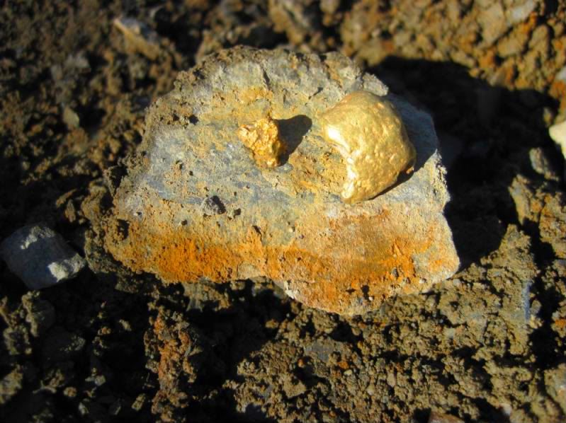

Making it to the inverted L area at last, I quickly had a loud, growling, in-your-face signal. Disappointingly, it sounded just like the cast iron junk I’d found earlier. But I scraped off several inches of material, and the signal became a boomer. It had to be trash, as that whole, long day I’d dug countless slivers of steel and trash. Regardless, I dug down deeper suddenly noticing the blackened nature of the trapped river run in the bedrock. This was ancient material, super oxidized with lots of deep purple, red, and dark orange staining. The surrounding clay had completely lost its natural color.
I drug the material from the hole with the pick and smoothed it so that I could pass the magnet through it, checking for ferrous. Nothing on the magnet. So, I ran it back through the muck again. No ferrous. I scanned the hole—the signal was still there, a loud growler. (As the signal came from ancient material, tight on the bedrock, I started to doubt my trash theory.) Digging down about an inch more, I spread the material out on some quiet bedrock beside the hole.
The signal was in the flattened-out material, growling so loudly I was convinced it was iron or steel. I passed the magnet through the spread-out material, but no steel or iron jumped to the magnet. And I couldn’t believe it would be copper or aluminum trash at that depth, in such oxidized material, but I was stumped by the loud sound.
Using the edge of the coil to pinpoint the signal, I grabbed a lump of that stained mess. Plucking out stones one at a time, I passed them under the coil to check for hot rocks. Not a sound. Looking back where I’d pressed the coil edge while pinpointing, I saw a narrow mark in the clay where a small lump of goo clung to the bedrock. I picked it up, passed it under the coil, and bam! A rumbling blast of sound.
The target was in the material, with the clay-goo far too heavy in my hand. Squeezing with my fingers, I hit something solid in the clay. I rolled the object between my thumb and index finger. Then the sun began to shine—right there between my fingers, the unmistakable shine of a solid gold sassy nugget.
At last, I’d found my first gold with the GPX 5000, a golden moment I’ll never forget.
Scanning a bit more, I checked the hole carefully, nothing. I switched the speed to very slow and checked the surrounding ground. A bit to the left, facing upslope, I got a bump in the threshold. Removing several inches of muck produced a definite whisper. Scraping some more, I had a tone. Digging down and flattening the material, I now had a solid signal. Finding no ferrous on the magnet from the material, I scanned again. Scraping the bedrock with my scoop, I captured the signal. Sectioning the material and scanning, I had the target on the coil. It too was covered in that deep, dark stain. While rolling the material in my fingers, out popped a half-gram nugget, very coarse and sassy.
Its big brother weighed in at just under five grams.

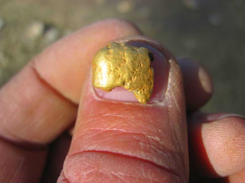

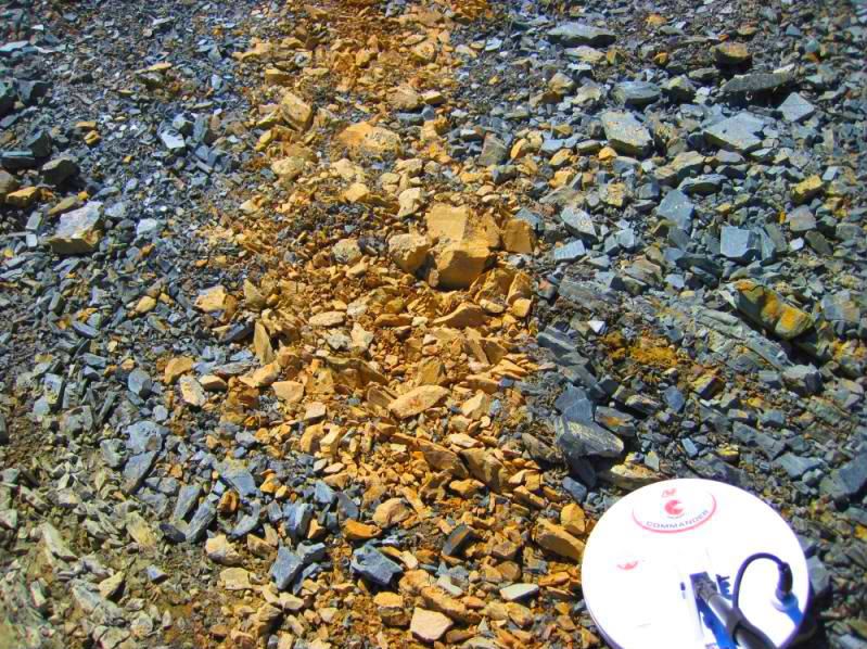

Little Beauty
I was out detecting with my GPX 5000, the air scented by pine, cedar, and fir. The sun was bright and hot, and there was no wind. It was a glorious day to be in the Rocky Mountains. Luckily, most of the mosquitoes had died off from the earlier cold, and there was no sign of the bear that had paraded through camp earlier in the week.
My machine was set to fine gold as I detected a patch of bedrock that had been heavily hammered by others over the years.
I used the elliptical Joey coil, a nice, sensitive little coil. I worked friable bedrock (bedrock in closely arranged plates or sheets) that rose at about a forty-five-degree angle close to a huge pile of old hand-stacked boulders. Cresting the top of the outcrop with the coil produced a subtle change in the threshold. So, I slowed down and scanned the uppermost edge again. The signal was still there. Something had changed that threshold.
Quite a few things can change the detector threshold: ground mineralization, tree roots, forest fire charcoal, hot rocks, and tiny bits of iron or steel. As well, passing the coil over a bedrock crest in either direction generates a very brief signal change while “cresting that curve”.
Nevertheless, this particular signal had a small center tone, making it unlikely to be a cresting tone. So, I grabbed my pick and removed some dirt from a pocket near the top.
The signal was stronger, and being a hot day, I used my amplified external speaker, rigging it up right below my left ear, making it much easier to hear quiet tones.
I chipped off more pieces of bedrock and scanned again. The signal was almost gone, so whatever it was had been moved. Scanning while heading down-slope proved the target had dropped lower.
Having chased signals in plates of bedrock before, when a nugget drops, it drops right quick into those plates. So, I used the pick and gently pried the bedrock pieces apart. However, I couldn’t find the target anywhere. This let me know it had indeed dropped into the bedrock.
Using a strategy I’ve used before, I tore the bedrock apart until I hit a perpendicular ledge at the base of the plates. These ledges stop anything that works its way down. Furthermore, a small pile of sandy clay, little river stones and some heavily oxidized pyrite had gathered there. This was a good sign. No one had cleaned this bedrock—ever.
I took a stainless-steel tablespoon I use for sniping, and along with some thin, flat scraping tools, I collected every bit of material, then placed it in a plastic gold pan. Taking the pan to a little seep of water located in a mossy gulch adjacent to an old Chinese wall, I panned the material.
Due to the small amount of material, I quickly had it cut down to concentrates. As I fanned the material, I noticed red, oxidized bits of pyrite, black sand, bits of ironstone, and tiny river stones. Fanning the cons some more, a sassy little nugget emerged from the super-heavies! A sub-gram nugget, it was the source of that small signal.
Never wanting to leave gold behind, I went back and scanned the bedrock, but it was now quiet.
Try this method the next time you’re out if you’re unsure of a faint signal on bedrock.
