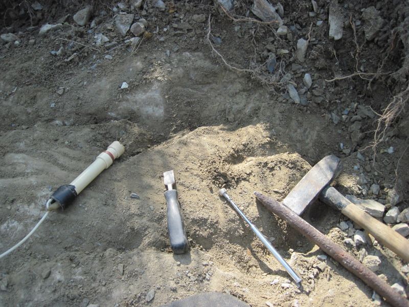

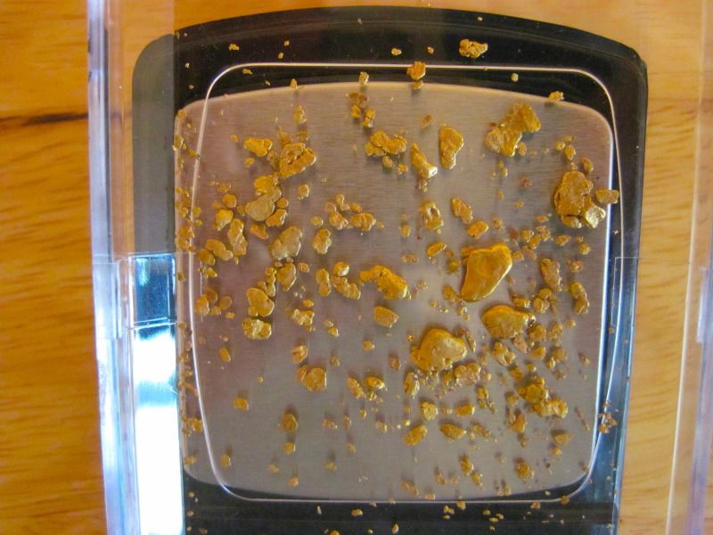

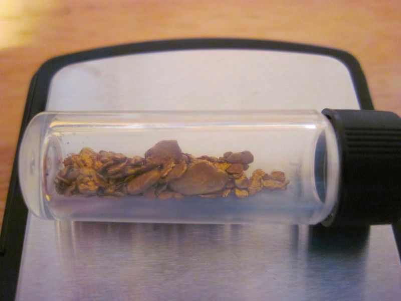

Here's some shots for you:
That's 4.20 grams of sassy gold--a little bit from some sample panning in adjacent areas thrown in, but almost all of it was found with that tiny little detecting wonder (The Falcon MD20) while checking worked bedrock.
Field test results:
Because of its tiny coil size and incredible sensitivity, I was able to get the Falcon MD20 into cracks and crevices I couldn't navigate with the bigger coils. Moreover, the rifle-shot detection capabilities of the machine, well it forces you to slow down and do a thorough job of detecting (new or previously worked bedrock) as you're now working with small patches and areas that you've cleared, not worrying about trying to cover the maximum ground possible in the shortest amount of time as a person usually does on a standard detecting outing. In fact, because I was forced to slow down, I was amazed at what I'd left behind!
Any time I got the slightest disturbance in the threshold, I'd chisel out any contents still trapped in the cracks and crevices that sounded off, and the photos clearly show what the results were.
As well, because the detector runs at 300khz, it found tiny gold right on the surface of the bedrock as well (you can also see the sizes of the tiny gold in the one photo clearly). Even my wife who'd never found any gold with a detector was able to find pickers trapped in the bedrock--the first time out!! (I tried to explain to her how remote the chances are of that happening, but it just didn't compute to her. She's happily hooked, and she certainly loves the extreme light weight of the unit too.
It's remarkable how small the tiny bits of gold are that the Falcon will find--I see great potential in using the Falcon to detect bedrock in dry areas far removed from panning water, because if there's any gold in dry bedrock cracks and crevices that are cleaned out during a prospecting trip, the Falcon will certainly see them, without any need for panning.
However, as you can see from the photos, if there's any gold of larger size, the Falcon will most certainly nail it.
Moreover, ID'ing hot rocks is a piece of cake anyone can learn in a very short period of time--minutes, in fact, is all it took the three people I worked with (a friend of mine bought one at the same time, and we tested them on a combination of day outings while on the gold claims), for the sounds were very easy to recognize. (Falcon sends a test card with each unit so you can practice listening to the sound of gold, pyrite, and magnetite [many hotrocks in our area are magnetite].) Oh, by the way, use a supermagnet on the end of a collapsable wand--it saves a ton of time as you're allowed to quickly eliminate many hot rocks (magnetite, other iron rich samples, etc.) by passing the magnet through the material you want to search; and, when you ID a hot rock wedged in a crack or crevice, or one that is trapped in dried clay, the power of the magnet easily removes the masking signal so you can scan the irregularities again for any subtle positive disruptions in the threshold.
As a side note, I even chose bedrock areas that had been avoided by other nugget shooters clearly because of the profusion of hot rocks littering the sites, but with the use of the magnet and the knowledge of the easy tone ID for hot rocks of the Falcon, I was able to eliminate all false signals and spend my time focused on positive signals, resulting in many sassy pickers discouraged detectorists had left behind, for the size of the pickers in the hot rock impregnated sites would have easily been found by larger machines.
(I may update this field test later with further results when I have more time, as this is a superficial, summarized account of the outings.)

Hmmm, what is that weird looking stuff on the scale?? Strange color!! ??? :icon_scratch:
:laughing9::laughing9::laughing9:
Wow! I love that bear that's in the middle of the first and second photos!! Love that sassy gold Lanny.
Eagle
Great to hear from you Eagle--thanks for the comments. I'd totally missed the bear, but now I see him!

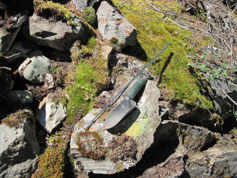

Here's some more pictures from the bedrock detecting outings with the Falcon:

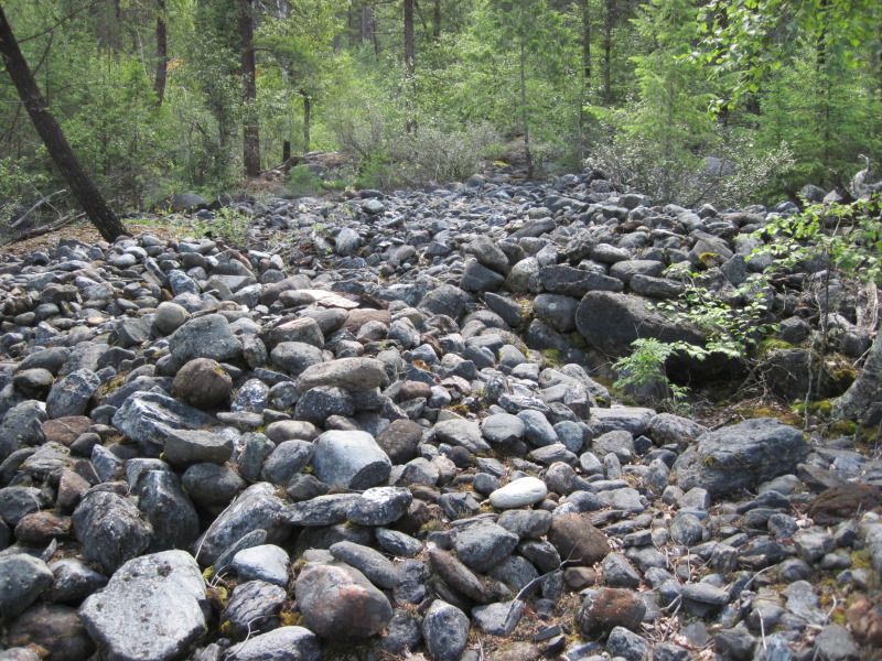

Hand stacks close on bedrock.

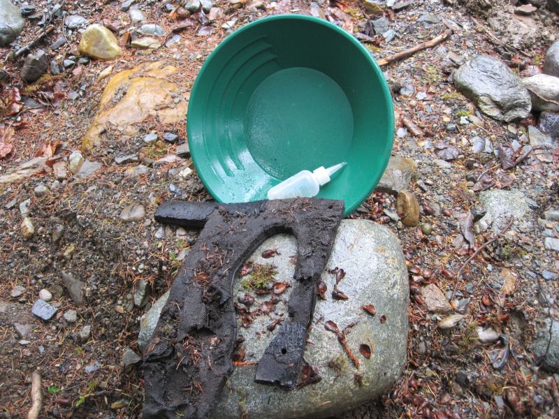

I love this photo as it clearly shows the ingenuity of a gold-seeker of old. He took a piece of belting, traced a sole for his boot and then cut it out to make a repair in the field--essential, yet ingenious.
Carefully covering recently worked bedrock that produced good gold--the Falcon easily found what was left behind.
Two essentials: a super-magnet on an adjustable wand, and a plastic scoop for target recovery.

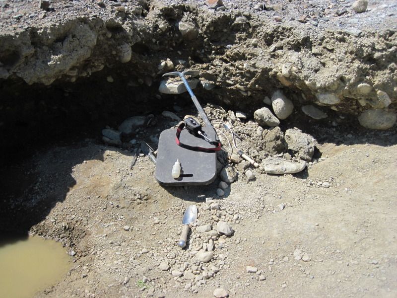

The Falcon and a very thick pad for sitting or kneeling on. It also works great placed on a five-gallon pail for a very comfortable seat!

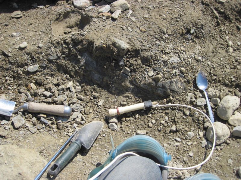

Spoons of various sizes make excellent crevice cleaners and gold capturing devices for retrieving samples to place targets, isolated in small amounts of dirt, in the scoop.
