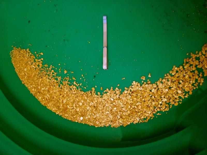

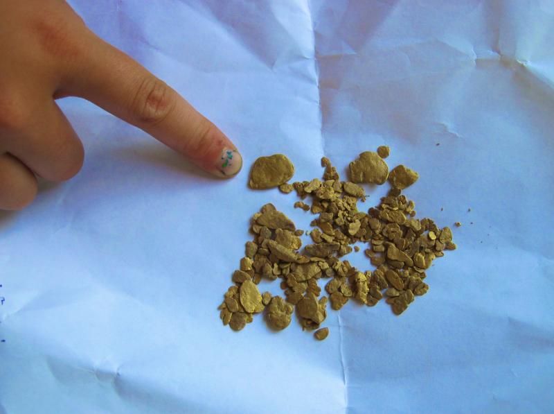

These beauties were found by a guy I went nugget hunting with one day in British Columbia. He then took a trip way up north of where we were hunting and this is what he found:
The big one in the middle (yes, it's quartz and gold, but all kinds of gold as you can easily tell) is over 1500 grams alone!
My friend Doc in Vegas has had this picture for years.
All the best as you drool over these,
Lanny

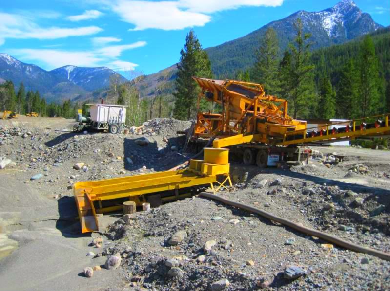

Flashback time: When I was working with a large placer operation and they'd hit large boulders (the size of your couch at least, not the cushions), and we were working ground where nuggets were common, everyone would get excited about the possibilities. (I say possibilities because sometimes Mother Nature plays tricks and only drops the big boulders because she shifted the gold run off somewhere else.) So, when those big boulders were moved out of the way, everyone would get down in the pit after the machines were shut down for the day to start panning. (I'd often be panning the material as we went down as well to keep the feedback going to the excavator operator to let him know what size of gold, or how much gold was showing in the pan at the various levels, or in the varying layers of materials as they changed from level to level.)
On one unforgettable day, the gold run was so heavy after the big rocks were moved that we walked along the face of the wall where it met the bedrock (from about two feet above and down to the bedrock that is), and we were able to see the nuggets packed in the gravel and then flick them out of the wall into a pan!
Now I know that some of you are going to think that I was smoking cheap crack, and that there's no way anything like that could ever be possible, but I was there and it happened anyway. Moreover, once you've seen pay with that much gold in it, and once you've experienced a sight like that, you can never forget it either. There was so much gold in the pay layer that because the boss was gone to town for supplies, the sluice crew messed up and fed the sluice at the wrong rate (they fed it as if they were running normal material). The boss arrived back in camp just as the run ended and the crew was just shutting down the wash-plant. To his horror when the water stopped flowing, there were nuggets all the way from the header boxes right to the end of the last riffle in both sluices, and this was a big wash-plant!
So, as you undoubtedly remember (by now in this post) that gold is heavy, what do you think was happening while the nuggets were being deposited all the way to the last riffle in the sluices?
That's right, the nuggets were going over the end of the sluice and heading down into the settling ponds too. What a fiasco! I'll not bore you with the colorful adjectives the boss launched at the sluice crew.
But, what an unimaginable sight regardless. Nuggets from the header boxes all the way to the last riffle!! I had my video camera with me and wanted so badly to shoot video of the sluices; moreover, I had my regular camera with me and wanted to shoot some stills as well, but the investor wouldn't let me do it. He was quite an uptight fellow, to say the least.
