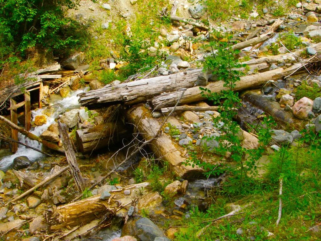

Interesting mining monument:
All the best,
Lanny
