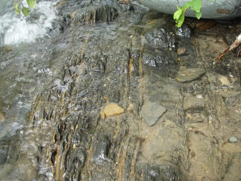

This past summer my wife and I were out looking for nuggets that needed adopting.
We were working along the side of a steep bedrock wall that then bottomed out on perpendicular bedrock in the river proper. I took a gold-sucker (gold suction gun) and started working the bedrock just below the surface of the water, but I worked it above where it T'd into the bedrock bottom proper. As I was forcing the water back out of the gun in a crevice, I noticed clay colored water streaming out of several other places below where I was working.
That's an indication that the crevice continued down a lot more than I'd first thought it did. So I got out a bar and started scraping the crevice and all kinds of loose material came out of the crack. I kept working it down until I'd dropped about several inches into the crevice. I could no longer get any material out with the bar (all of the material went into a pan). I panned it out and there were nice flakes of gold in the pan.
I used the gun again and I could still see clay in solution streaming out below the crevice. I got the narrowest scraping tool I had and worked the crevice again, putting the takings in the pan. This time there were only a couple of pieces of gold, but they were chunky, not flat.
I really went to work with the gun then and worked the crevice as hard as I could and the tip sunk a bit more.
When the gun was full and would take no more material, I popped the end off and dumped the contents in my pan. When I'd panned the lighter material off, there was only a small amount of crumbled black slate left in the pan. As I worked it down and swirled off the lighter material, cubes of oxidized pyrite started to appear; moreover, chunks of magnetite were also in the mix. (These are all good signs in the area I'm currently working, signs that I've pulled out the
super-heavies from the crevice.) I shook the material down again, panned off the lighter stuff that rose, then tailed the concentrates once again.
Right quick, a sassy nugget poked its nose up! It was a little beauty, just under a gram, but it had been in that crevice a long, long time. One end was heavily rust stained from being wedged against that pyrite for who knows how long.
So, if you're ever shooting water into a crevice under the water, and you see clay streaming out of other cracks below (or to the sides, or above) the crevice you're working, keep at it until you've reached the bottom! Furthermore, if you're allowed to take the bedrock apart, keep working it apart until you find the source of the cracks the clay is streaming from. At some time that crack may have been open and it may have let in a little bonanza.
I've taken nuggets out of cracks that were way smaller than the width of the gold in them. So, that pops the question, how did they get in there?
Well, there's theories on that, and one of the theories is that when big boulders were pounding down the stream bed, the raw power opened the cracks wide enough to let the gold drop, then as the boulders moved on, the crack snapped shut again. Whatever the reason is for gold bigger than the openings of cracks being where it is, it's irrelevant.
Just be sure to check out those cracks where the clay-colored water is streaming from.

What to do when deciding to check bedrock for gold.
I’ve written about this topic before, more than once, but I keep getting asked about it, so I’ll try to review a few basic principles.
If you want to check bedrock for gold, it has to be the right kind of bedrock. There are exceptions as I’ve discovered while using a metal detector, but we’ll stick with the general guidelines, unless I decide to tackle unusual bedrock in a follow-up post.
What do I mean by the right kind of bedrock? Well, if you look at the concrete on your driveway, or the concrete of your basement floor, you’ll see that it’s generally nice and smooth. There’s really not much of a chance that if a big gush of water carrying flakes or nuggets of gold flushed over your driveway or basement floor that the gold would have any place to get trapped.
That’s the key to gold and bedrock: the bedrock has to have some traps in it to catch the gold. For instance, if the concrete in your driveway had a large crack in it (let’s say at least an inch wide) that spanned the width of your driveway, and a big wash of water carrying gold was flushed across it, the gold would drop into the crack. As long as the water was flowing with sufficient force to propel the gold, it would only stop where it had a chance to drop, so it would likely be a waste of time to check the smooth concrete for gold. The time would be best spent investigating the contents of the crack.
When it comes to natural bedrock, the same thinking applies. If the bedrock is smooth, there’s not much chance of finding gold (there are exceptions to this, but they have to do with unique situations and geological processes). However, if the bedrock is heavily fractured, those fractures will work as natural gold traps. If the fractures run across the stream (perpendicular to the bank), they will work the best as gold grabbers. If the cracks and crevices run parallel to the bank, they will catch some gold, but they will not be anything near as efficient at stopping the gold as the ones that run across the stream. Having said that, please don’t think that parallel crevices aren’t worth investigating, because they are. I’ve got some nice nuggets out of them before, but the odds are against the parallel crevices, and they are dramatically for the perpendicular cracks and crevices. Moreover, if you go to all the trouble of clearing overburden all the way down to bedrock, investigate every crack and crevice!
In addition, if you are lucky enough to be working on dry bedrock that you’ve cleared, use a large sledgehammer to hit the bedrock so you can hopefully find a hidden crevice. You’ll know the crevices are there because as the hammer strikes the rock, little puffs of powdered clay (looks kind of like fine smoke) will float up into the air from hidden crevices (the principle works under the water as well). I’ve been given this tip by several Sourdoughs over the years, and it really works as a way to help identify where a crack is in the bedrock. Will every crevice or crack located this way have gold? Absolutely not, but it’s a great way to give you a new spot to check that most other people have never tried.
I wrote the following notes up in another post as well, but I’ll re-post it here: If you can imagine huge boulders (car-size to house-size) pounding down a streambed, with gold flowing along with them, when a big boulder bangs on the bedrock, it could very easily cause a fracture in the bedrock to open up for a moment. The gold could then drop, and as the boulder continues its journey and moves off the crack, the lessened weight and pressure on the opening could very possibly allow it to “snap” shut. This is one way of explaining how I’ve found nuggets, chunks of magnetite, and other stones in cracks that were much, much larger than the opening. There are probably other explanations as well, but regardless, somehow nuggets that are far larger than the crack’s opening get themselves trapped in the crevices!
