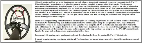

I prefer the concentric coils.
When I pinpoint with my ACE 250, I center the target left to right and pull the coil back toward me. When the audio cuts out i know exactly where the target is. Will pinpointing be the same with the DD coil ?
If you are talking about off the tip of the coil you are right. You can also use the center, but it is faster off the tip.
Yes, i was talking about off the tip of the coil. Thanks Sandman.
