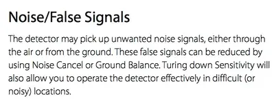

This what I am going to try next
6" COIL
park 2
All metal mode on
2 tone
ferrous set to 0
sensitivity 15
recovery 7/8
IRon bias 1/2

Also try Field 2 with similar settings if Park 2 does not work out to your satisfaction. You may be able to bump sens to 17-18
