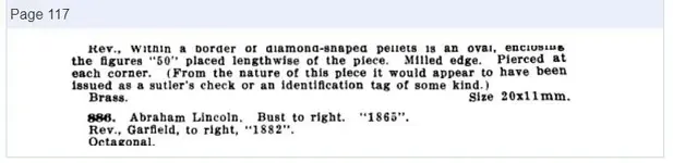

Yes great research Bramblefind. Interesting there are so many of these and none attached to anything. I tend to agree with you Matt. Lest we not forget the actual size of this thing which is 20mm x 11mm or about the size of one of these earring hooks, small for a token or chit imho...

I agree too - I'm not sold on the sutler token either. It appears that some of the biggest experts in this field of study haven't been able to firmly place what these are.
This is a snippet of the listing for "King-885" from the Robert P. King book "Lincoln in Numismatics" from GoogleBooks-
