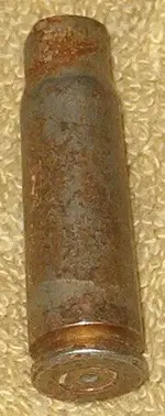

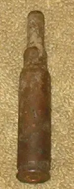

These are some cartridges I've found.
The first pair is of a live round. It is 1 1/4" tall.
The second pair is also live, but appears to be a blank. It is 2 5/8" tall.
The third pair is spent. It is 5/8" tall
The fourth pair is also spent. It is 1 1/2" tall.
Thanks in advance.

Your second set of pictures is a blank made in Lake City Arsenal in 1968. It looks to be 7.62X51 which is the military equivelent of .308. The 4th set looks to be 7.62X39 Looks rusty so probably a steel case. Steel cases are common in this caliber. I think that particuler head stamp is Chineese but could be wrong. Lots of this cal has been imported and sold here.
The 3rd one is for some caliber semiautomatic pistol, probably .45 ACP. I don't collect them but I handload them and they are really too common to be worth anything. But a new collector might want them. The 3rd one isn't a blank. A blank would have a crimped spot in the place where a bullet usually goes. It is a US. cartridge from the Lake City Arsenal. Monty

#3 is a .25 auto pistol cartridge.
Sorry Monty, The military round is a blank. I have a clip & eight on my desk as I type. The crimped rounds are for grenade launchers. There were two rounds taped to the shaft of the grenade. The large pistol round is .455 Webly & Scott revolver. The small rimless is .25 Auto (ACP)
I give up, I can't tell #1 from #2 from, etc, etc. From the picture I thought the military rifle round had a bullet in it. I was going to guess 6.5 MM but I suppose it doesn't have a bullet in it. Dang, there went my ID percentage back down to about .26%! I am usually pretty good at this but my brain went to sleep on this one I guess? M :notworthy: nty

The 3rd round IS A BLANK. I worked at Lake City from 1965 to 1971 and could have loaded that very round. That is 7.62 blank round for link belt only. Most likely used in training with the recoiless rifle. After the plate of cases were charged with powder they were run through a wad press, which placed paper wads in the extended neck. Next the plate was run through a crimping press and end of the neck was curled over the wads. Next water proofing was placed in the end of each round. Each plate held 346 rounds. And thats all I have to say about that
