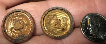

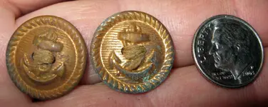

Howdy All, I just got this pile of "Civil War" buttons on Ebay. I really know nothing about buttons so thought i would ask if any are really Civil War or not. First pic is the whole pile. Next 4 pics are small dark buttons. Next pic is of back of small shiny buttons {front is same as dark buttons}. Next 2 pics are screw backs. Next 2 are large shiny buttons. Next 3 are large dark buttons. Next 2 are of plain front button. Last 2 are Navy buttons. Quarter, Dime, and Nickle are for size. Names on backs are ARNSTEIN SIMON & CO, SCOVILL MFG CO. WATERBURY, EVANS & CO., RIDABOCK & CO. NY, . Thanks in advance for any help. I only have about $25 in the pile so no great loss if they are not. steve

sorry to tell ya but the "Eagle",buttons are Great Seal and date no earlier than 1902

I dont see any CW buttons either. . 46dredger is in outer space or straight out lying. He/she did however offer to return them or risk bad feedback. The rich gold plain button may be old. All the others are post 1900. However the RIDABOCK & Co. NEW YORK is a WWI button that may not be on my list. Can I add your picture to my thread? They are worth a buck a piece. The collar discs may be more. http://www.treasurenet.com/forums/what/112828-great-seal-button-backmarks-help-5.html

In case you'd like more-specific IDs of your buttons:
The ones showing an eagle underneath a circle of clouds around a group of stars, but without a raised border/rim at the button's edge, are US Army buttons from 1902 to 1910. Same emblem but with a raised border/rim and a "BLACK finish" are from the World War One era.
The two discs showing crossed flags, with a screw-pin on the back, are US Army Signal Corps collar-insignia dics, issued from 1910 to 1924. For verification, go to the following website and scroll down to "Examples of Bronze Left-sided Collar Discs, Type 1". Dating Metallic Insignia: Collar Disks
The two thin stamped-sheetbrass buttons with an anchor are front resemble civilian-clothing coat buttons, missing the button's back. But there's a chance that they are the fronts of some kind of European navy buttons.
There is one 19th-Century era button in your group. It is the small plain-faced one, whose back is marked "Rich Gold Colour." (Note the British spelling of the word "color.") It was manufactured in Britain sometime from about 1810 into the late-1830s. We dig lots of that kind of plain-front 1-piece solid brass buttons here in Virginia, and we diggers call them simply an early-1800s flat-button. They are so common in Virginia that they sell for $1 to $2.
But don't feel too badly. Despite that ignorant Ebay seller's awful misindentifiction of those objects as being civil war era, the two World War One collar-insignia discs for the Signal Corps are much rarer than Infantry stuff, so they are worth more than the $25 you paid for all the false "civil war buttons."
