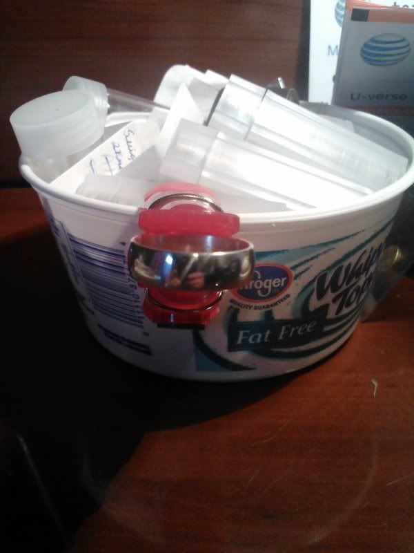

I use some jewelers rouge and a buffer (Dremel or bench grinder with buffer attached).
Here is before:
and after:
