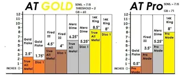

I Would like to see a head to head test with the PRO vs Gold on Beach, park and relics
It may have been done but I missed it// Perry
That's a great idea you have. Both machines to share. Below are some graphs and comparison data you might find interesting.
Thanks John // Very good charts// It looks like the Gold will do about = to the Pro and better if we should get out to gold country//
Now I would love to see the Gold vs ATX beach, park, relic--Gold //
Still 15 deg and snow cover so fun to think about// Perry
Perry, the AT Gold is not recommended for saltwater beaches. It is extremely sensitive to sub gram gold, therefore the minerals in saltwater will cause you to have to reduce your sensitivity. Parks and relics, I'd use John's charts to compare performance. Wayne www.metaldetectingstuff.com
