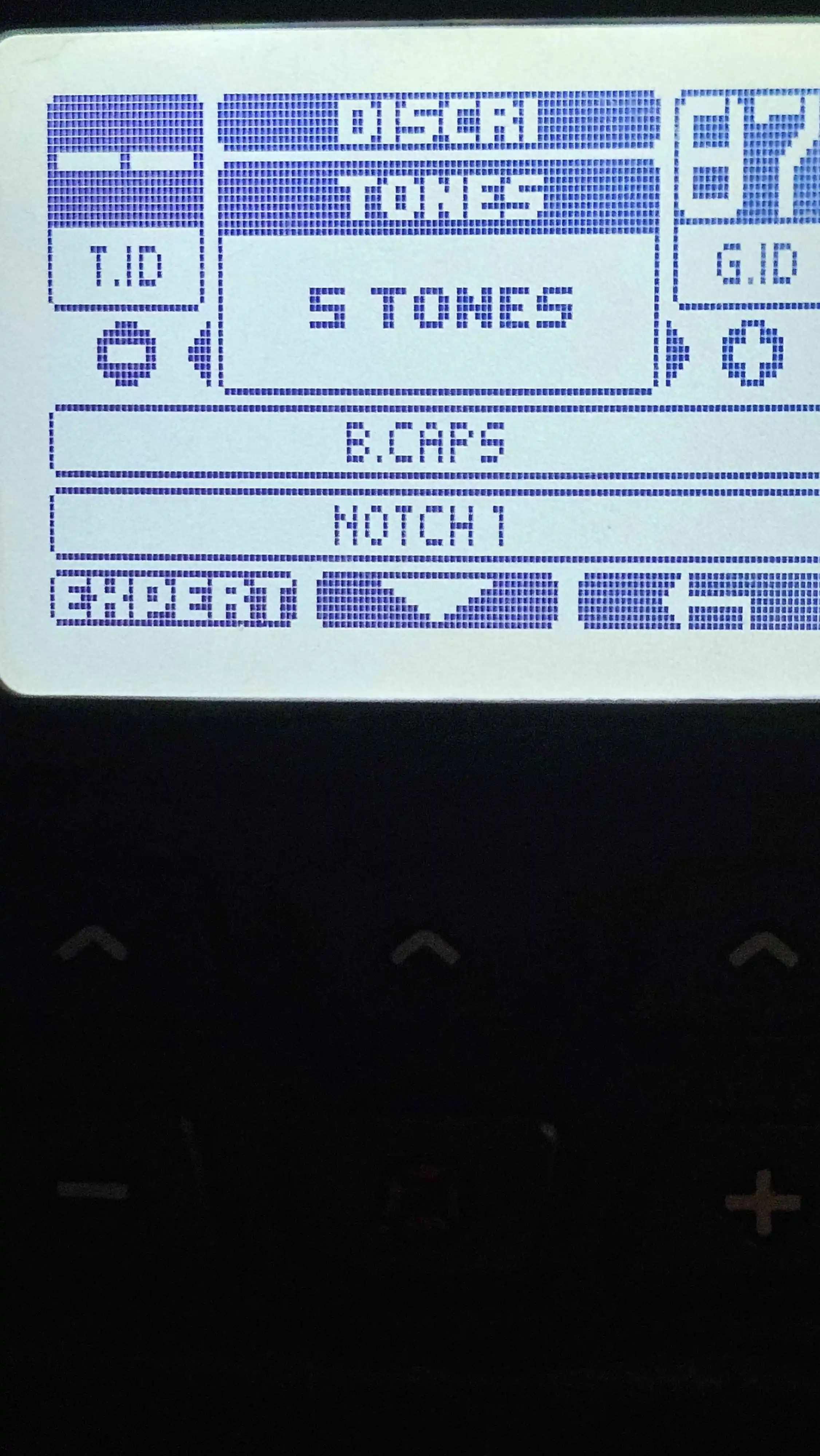

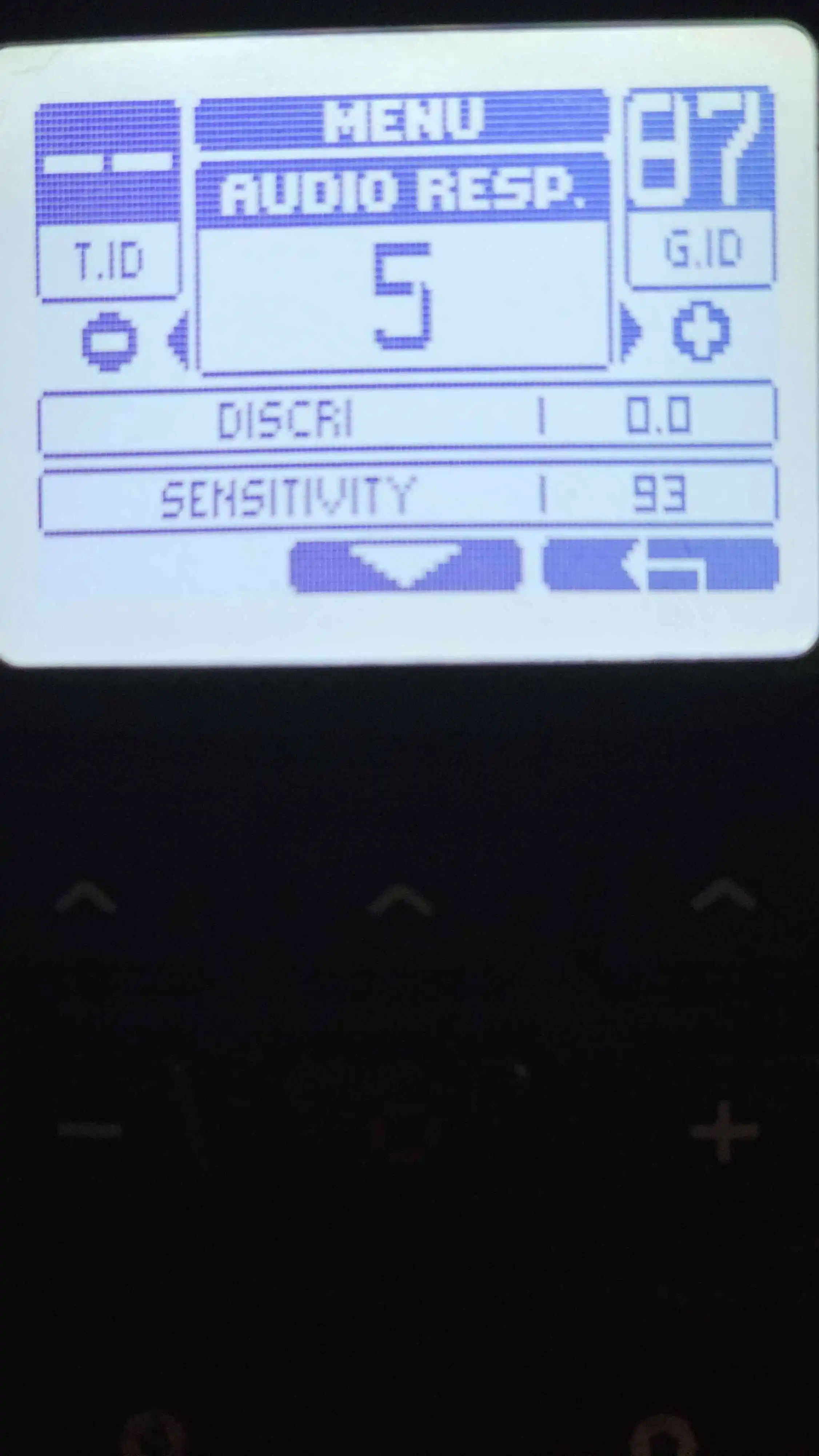

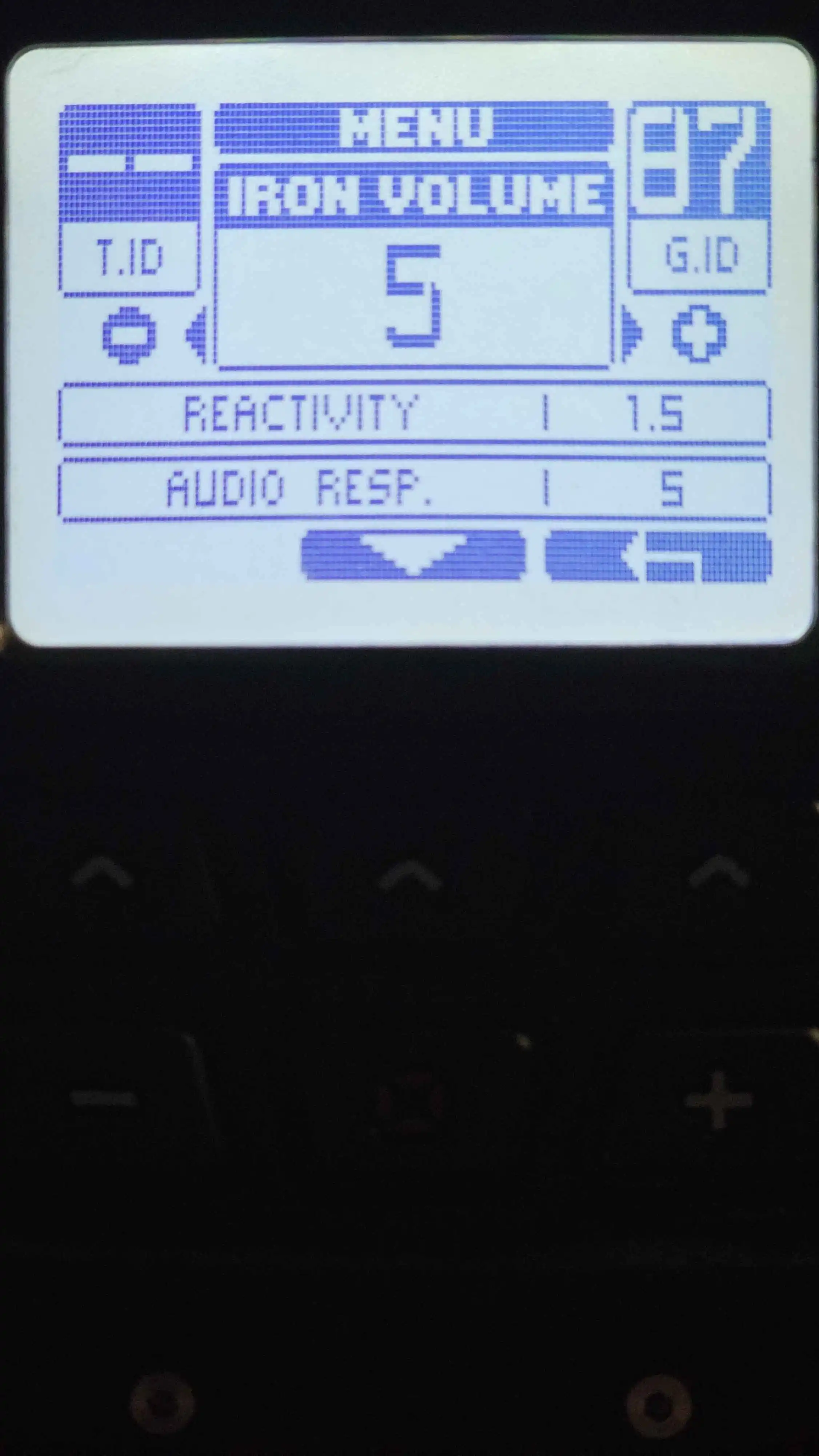

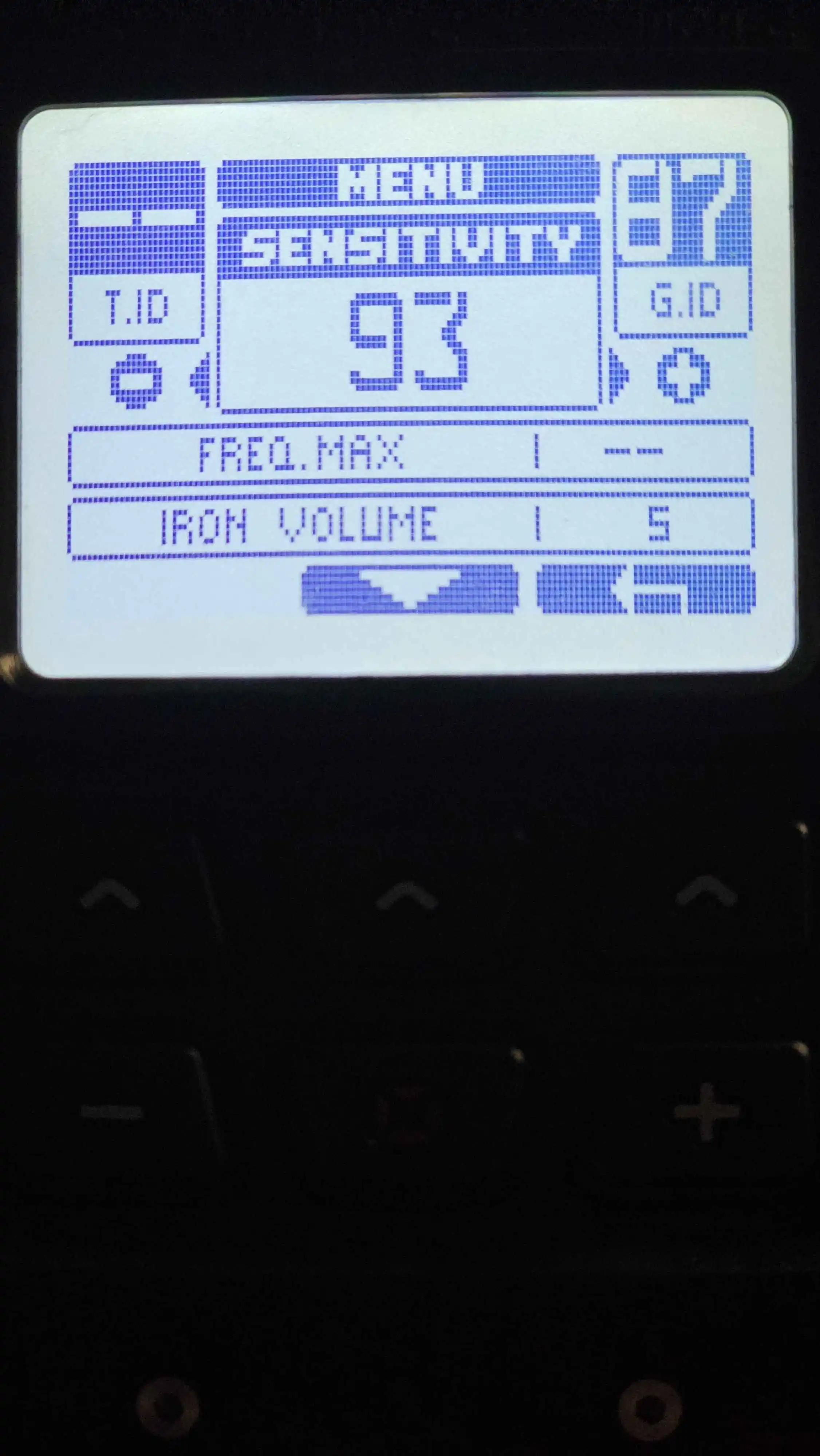

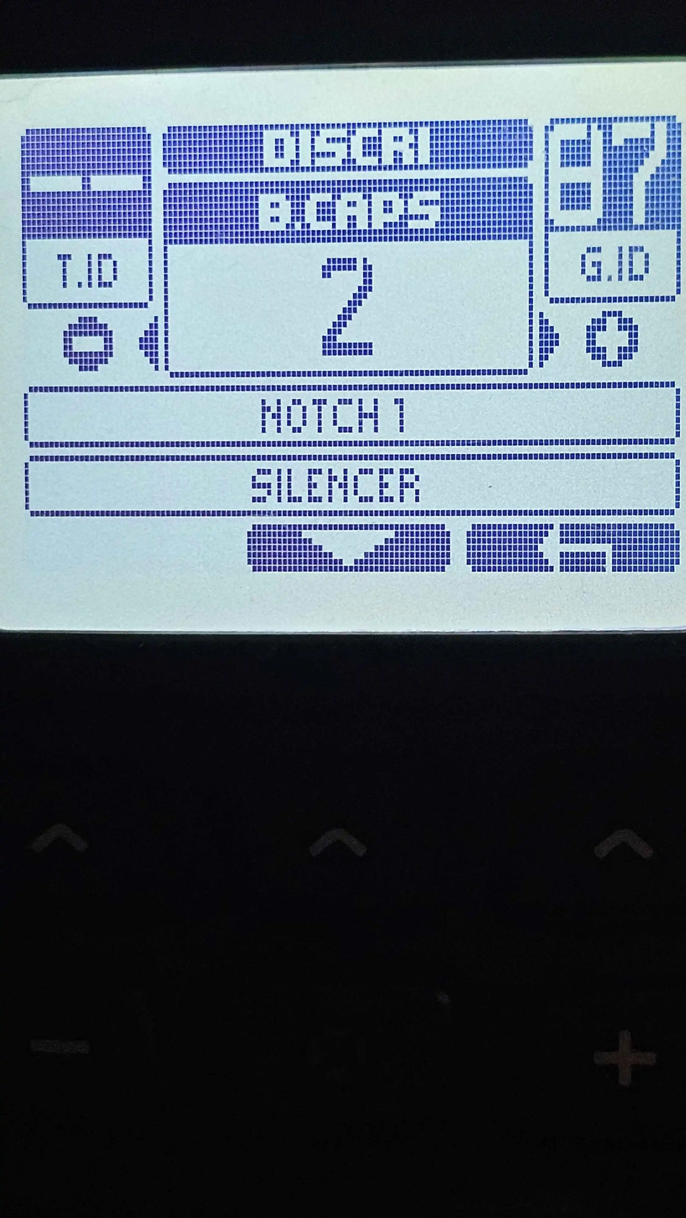

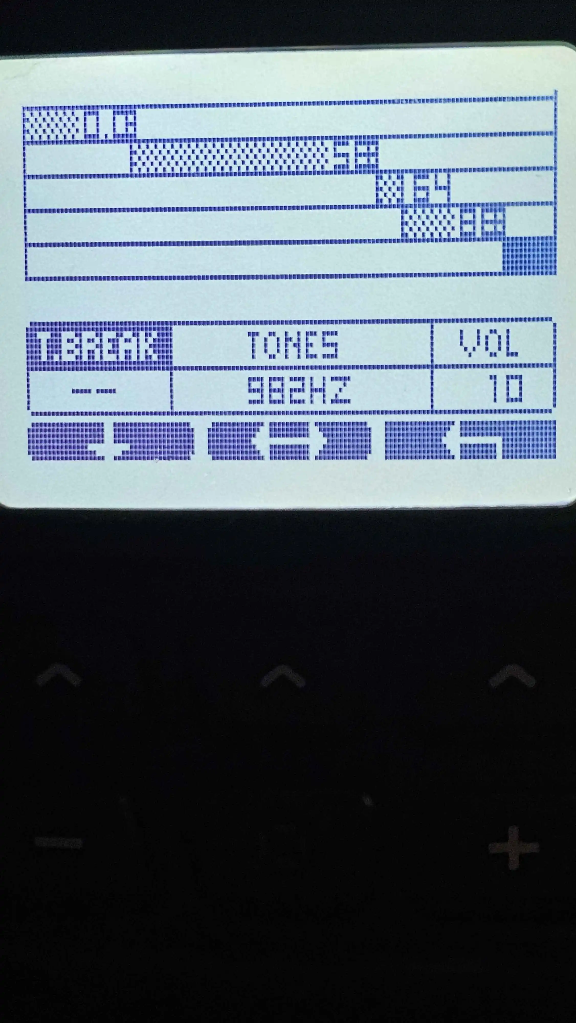

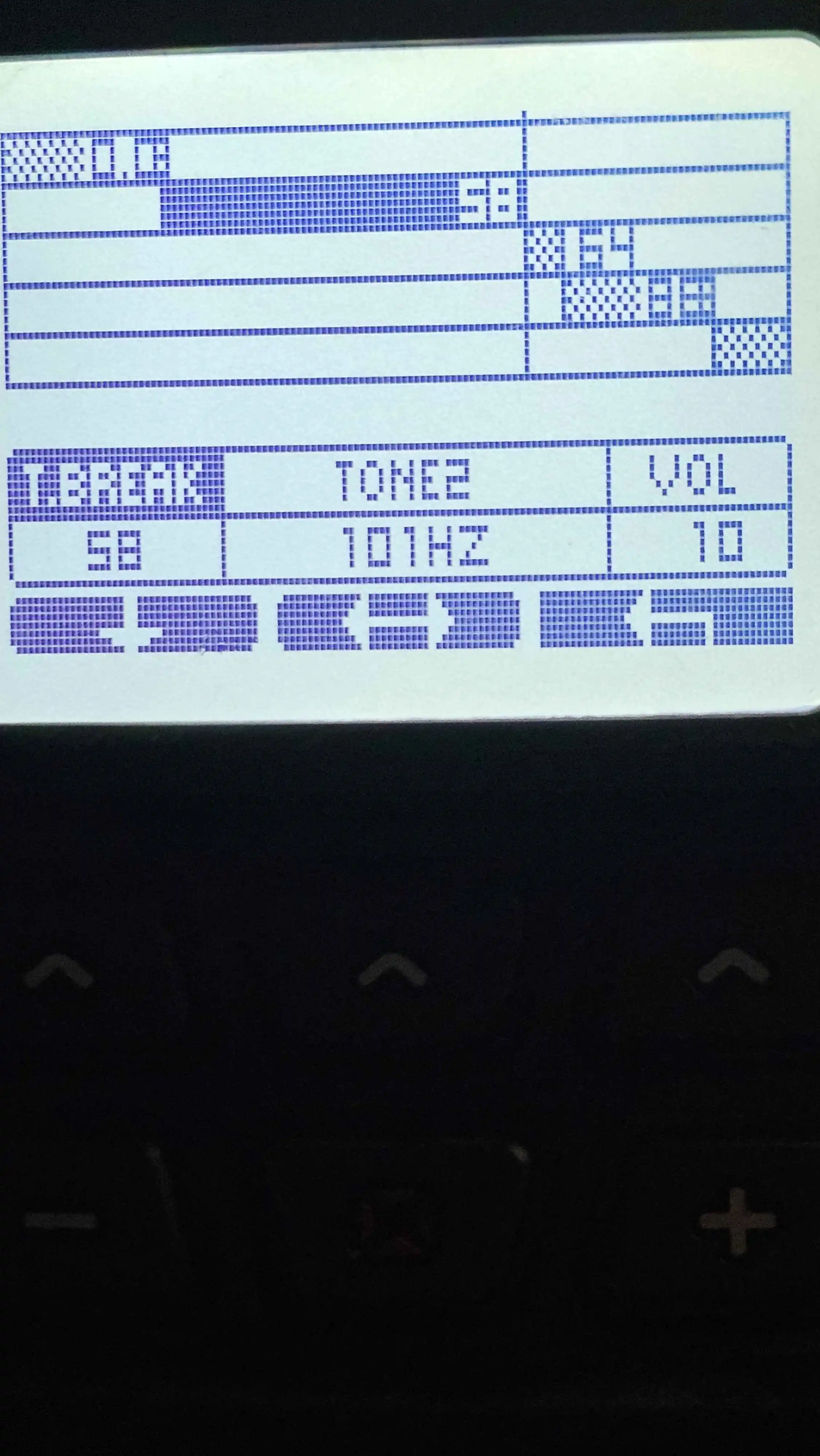

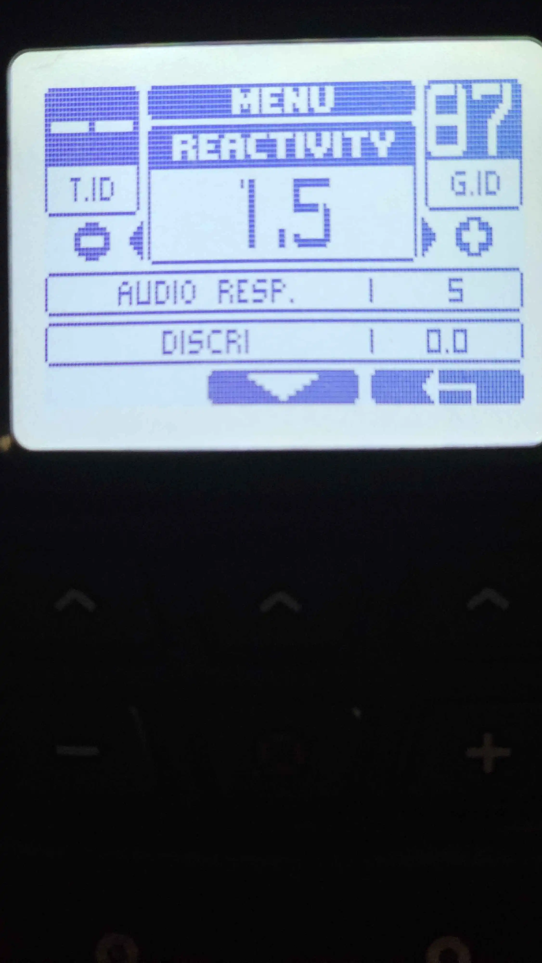

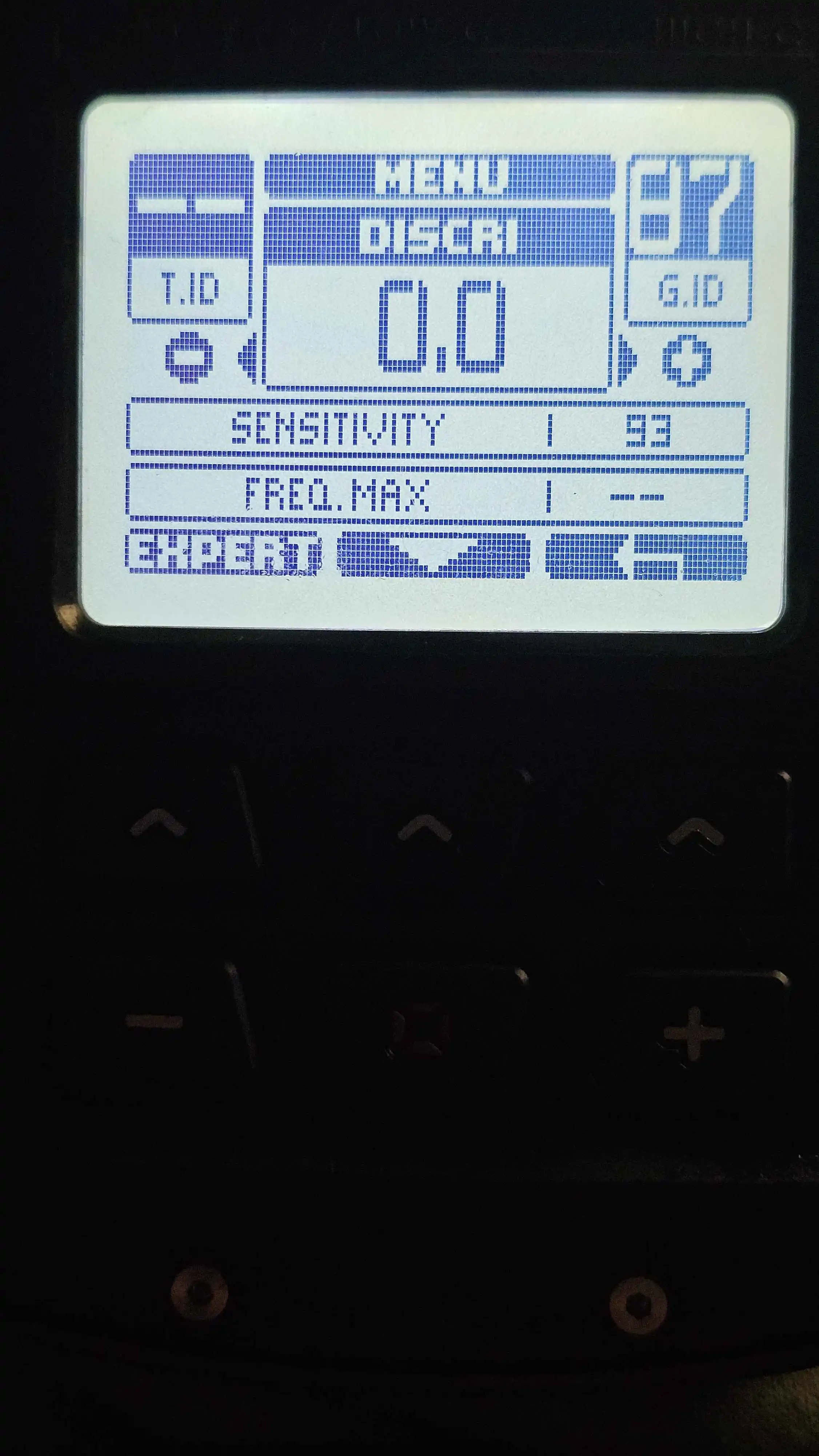

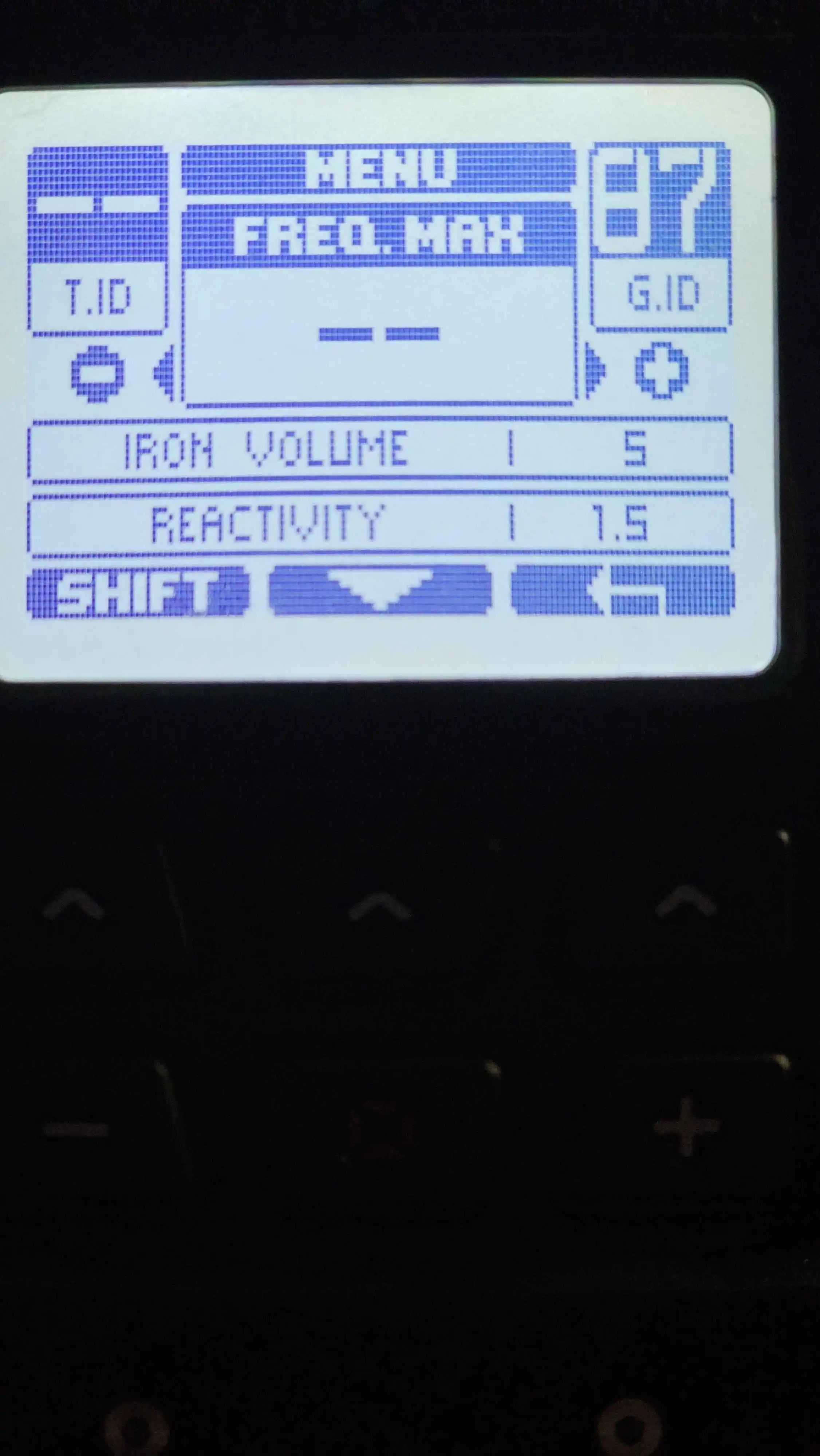

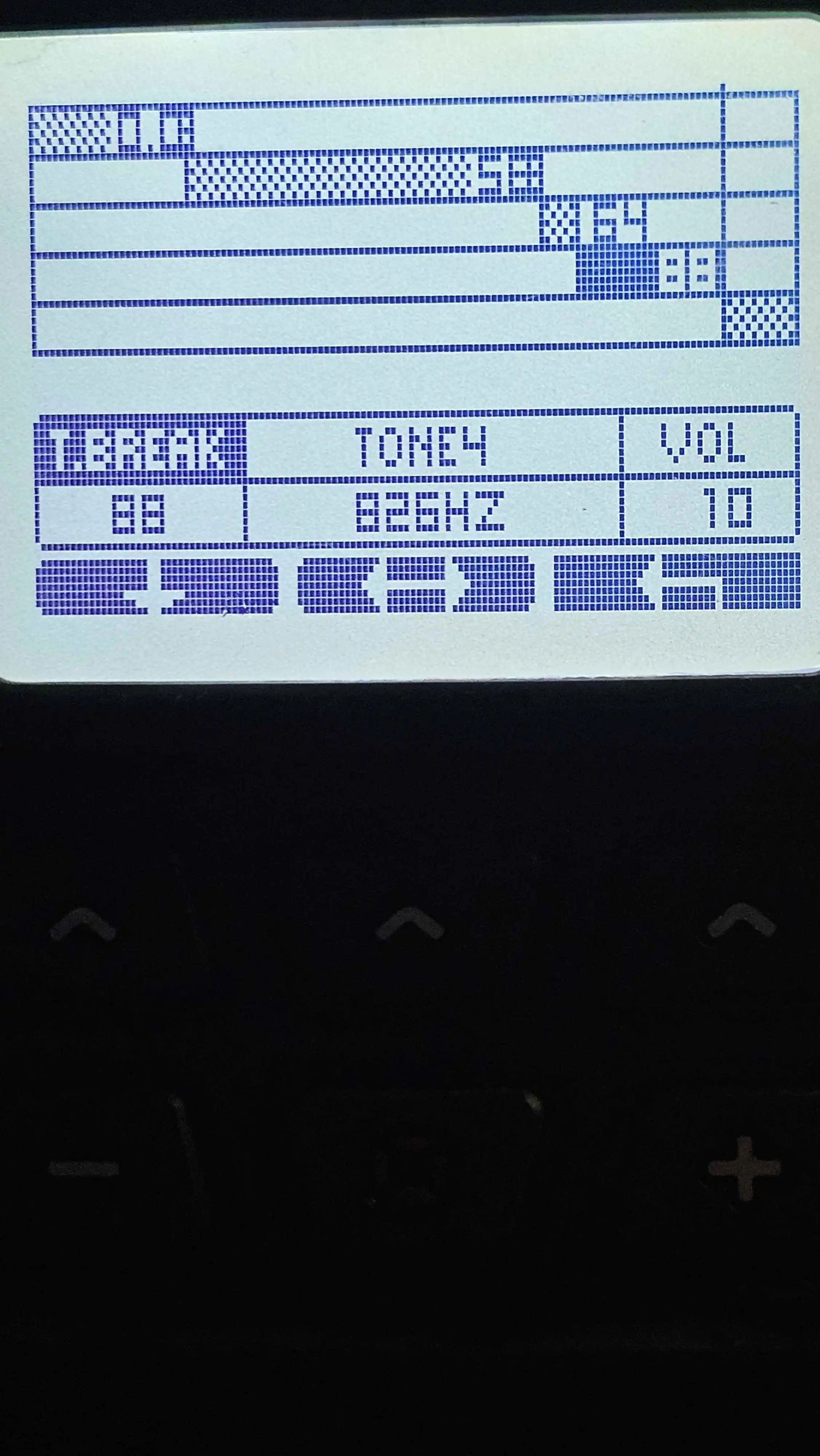

I've had my Deus II for about 6 months and I love it. I copied some coin program from a YouTube video and it works really well for me. But I noticed while testing some items that it won't read IHP's at all. I don't want to switch programs because I like this one, so I'm wondering if anyone could help me with the settings to find out what I need to tweak to get it to read them. I'll attach the pictures of my current program. Thank you!

I'm not an expert, but I don't see anything in those settings that would keep you from hearing an IHP.
What's the notch look like? Maybe something is notched out?
Deus 2 users.
You can look at top of screen. I believe and see notch. Look close.!
Why am I bringing this up?
You can have notch dialed in on line. 2 and line 3 with no notch on line one.
What does detector tell you when you look at notch accessing disc submenu notch ? It will say Notch 1 OFF.
Yet there is notch in the machine possibly. In line 2 or line 3 or both.
