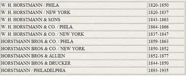

There where different variations in the wings and shields caused by the different manufacturers. At least that my opinion. ;D
Here are the Horstmann backmarks.

Breezie, after a button is (#1) identified, it can be (#2)dated by its backmark. I dont know when the HORSTMANN. PHILADA * backmark was used because its not listed. :dontknow:

I believe the button in question and the one breezie has shown is probably 1875 to 1893. There are several details that can change the time frame on a backmark. I personally do not have any books and only go by my own personal finds and info that i have collected . I definetly need to buy several books to help confirm what info I have. Here is alittle info about the Horstmann Backmarks and some other info on how to help identify eagle buttons.
W H Horstmann & sons 1843 to 1894 (this is when the sons William and Sigmond became partners
Horstmann Sons & Drucker 1845 to 1849
Horstmann Brothers (1859 to 1893) These "brothers" are the sons of W H Horstmann working together after the founders death.
Horstmann Brothers & Allien 1850 to 1877 , this is the brothers (sons of WH) working with Henry V Allien, after the founders death.
Civil War period buttons have a shield level with the rest of the eagle, while those made after 1875 have a raised shield. After 1902 modern style uniform buttons with the Great Seal of the United States, replaced the Civil War type eagles.

According to my list, its an 1859-1863 backmark. Its not unusual to have an older backmark on a button because they used up the old stock. I have late 1800's backmarks on 1902Great Seal buttons like the one I posted.
