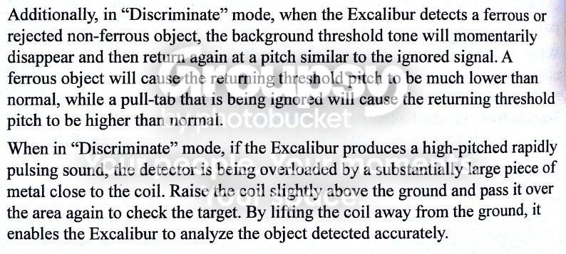

I think if you go over a fe target the threshold comes back with the low buzz if it goes over a non fe target it comes back normal. I just swing mine over my scoop to get the normal threshold back. Go over a nail and you will get the low buzz threshold. Go over a pull tab and the returning threshold will be higher.

Just know that everytime that low buzz threshold comes on you just passed up a chunk or iron or hair pin. It's took me a day to figure it out but I am getting use to it. I just wave it over my scoop to get the normal/conductive threshold back. I hunt mostly in fresh water so I get lots of bits of iron, so mine is just about always in the low buzz threshold.
This is from the Excal 800 Instruction Manual

But from what I am told and read and heard when using it gives you info on what it discriminated on when going over it so that is valuable info to have.
