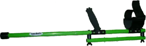

So I was planning out building my straight shaft and pricing it out. As I was doing that I had an idea. I know I want the unit behind my arm, like this anderson shaft:
So, my question is, Can I just add a bottom piece like that to my stock shaft? Why make a straight one when I can use the stock and put the unit on the bottom? Or am I not considering something? My unit came with a waist mount, so I already have a bar and I have some 1/2 PVC that appears to be the right size too so I could use either. The MD would look like a cross between the top image and this:
I already use a Whites DF and its comfortable. So I assume the Minelab could work like this too. There are 5.5 inches of space and that should be enough for stability. If it doesn't work, I was going to make a straight shaft from PVC but I am not sure its sturdy enough. Either way I need to make that bottom piece so I will try on my stock first and see how it looks/feels. I will post pics later today when I have it done.

The Anderson shaft you have posted isn't behind you arm, it is called the Anderson over under shaft, the controls are below your forearm..... They make extensions you can add to the back of the stock shaft but they are not as comfortable as a straight shaft.. Purpose of the straight shaft is to counter balance the coil, the more weight and length behind your elbow the lighter the front of the shaft is...
Do you think that behind the elbow is better than the over under? I like the idea of the over under and that was what I was planning to make. I feel like the behind the elbow one you posted might get in the way of me swinging but IDK I have never tried it.
I am confused as normal. Is your question about the stock "S" shaft that comes with the Excal.? If so I see no reason why you could not modify to over under as the Anderson shaft but you will need to mod. parts as well to space the detector from the shaft and I guess PVC 1/2" would work. My suggestion though would be to take one of your expensive detectors listed to the beach and pull a couple gold rings, scrap the rings and contact Pete Anderson and buy the over under shaft made for the Excal. It can be modified to behind the shoulder later if over under is not your cup of tea.
I'd just replaced the S shaft with a Plugger straight shaft, with controls behind my elbow.
It does NOT interfere with my swing, and my elbow sure feels a lot better with weight re-distribution.
It has never interfered with my swinging, I have tried both and I prefer the behind the elbow, of course both of my excals have the remote pinpoint switch so I don't have to reach anywhere to switch back and forth..... For me the counter balance is much better behind the elbow, I have used the straight shaft for 10", 12', 15" and 12x15" coils.... I prefer hunting with 15" coils as I get more depth and coverage.....

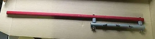

Well I had an aluminum broom handle in my garage with no broom so I am just making a straight shaft. So far I have spent $16 on screws, pvc, and a bike handle bar but need 2 more parts - ...the arm cuff and the little spring locks for the battery/casing unless I should just use stainless steel screws?. Any good places to get them? I searched ebay but the cuffs were around $30 and spring locks were all in china.
I may also get some marine paint and paint it when its done because the aluminum shaft is bright red lol
You can pull the spring locks out of stock shaft with a clothes hanger or piece of tig wire with a little J hook bent on the end. If you can find a welding supply store most of them have some steel, stainless and aluminum tubing/pipe.
Have you checked to be sure it is perfect fit for lower shaft?
Yes I tested it on the dive shaft. It was a pretty good fit. There is a hair of wiggle room similar to my cz21 stock so I don't think I will need to do anything else for it

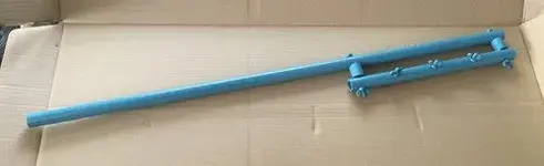

Here is the draft.
I still need to order an arm cuff, any suggestions? Or should I just use the one on my stock shaft? With the sping locks and handlebar my total is $22.45. I am going to get some marine paint to paint this thing so that will run another $12-15. One thing I should mention is that if you are building 2, its even cheaper because when you order the bike handlebars you get two, you have extra PVC, extra paint, etc.

Shaft is painted. I got some discount marine paint at the boat store for $5, it was $13-$35 at lowes. I thought it would be darker blue but its ok it will fit in perfectly with the 80s theme excal colors. Still need a arm cuff recommendation if anyone has one. That is my last piece.
