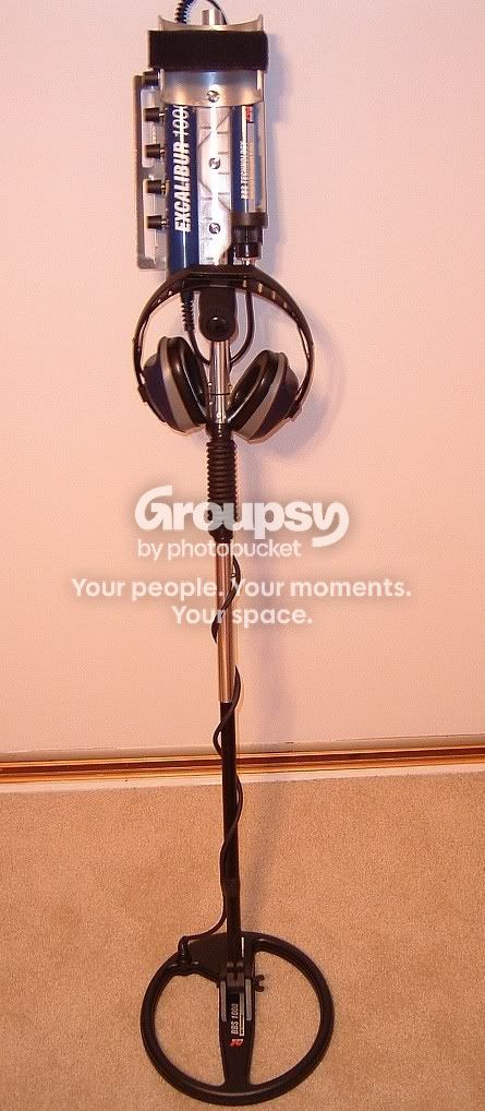

SWR, do you have any pictures of the straight rod?
some for u
I have the one like Max posted, leaning against the wall.

You can hip mount the unit... many do that. Get the straigh shaft. I have a "travel" version that breaks down even smaller (pic is below). I think I got it from proscoops.com... I can't remember.
