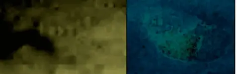

It can work if you get the right historical image for good water clarity, do a good job of enlarging/cropping the images, use a large enough flat screen on the computer. Then only certain wrecks will show up, even if searching an area full of shipwrecks.
First photo has GE satellite image on right compared with on the left side, a wreck found by someone else in the shipwreck board here using underwater scan equipment.

There are many well documented wrecks in the Keys in pretty clear, pretty shallow water. Look at your satellite images of known sites to learn what to look for.
