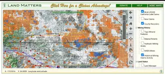

Looks like you need to hit the recorders office -
Reed, I've seen that before. It looks like the whole area is claimed by either placer or hard rock miners.
I don't even know anything about recorders office. I do know that those townships list, sometimes more than one claim. And some just one. So the whole area isn't completely taken. Just the spots with possible gold.
I'd like to obtain a map of our area with detailed claim boundaries, but I doubt such a thing exists.
