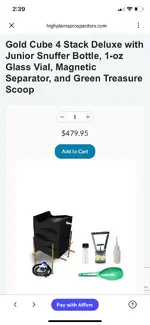

John, Is that your dream fine gold cleanup device? I've heard good things about it, though never used one. Maybe you'll get one for Christmas.

Don't bother with the Gold Cube Caley, it's for a different application from yours. Your table is perfect. I threw together the panning video today and at 9:30 watch the light tapping method for actually bringing gold back from the lip on the bottom before it falls out.
