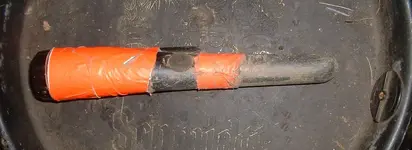

as I don't intend to do without & wait for a decision, The Discount/ trade-in Will be too Late, So I'm just going to Order a New One Monday, & keep the old one as-is (Screwed up, but passable in an emergency) I suppose I could Complain about Garrett. But it is 11 years Old.
It is Decorative though.
Look like New ?
It looks like it's ready for Halloween. 😁
