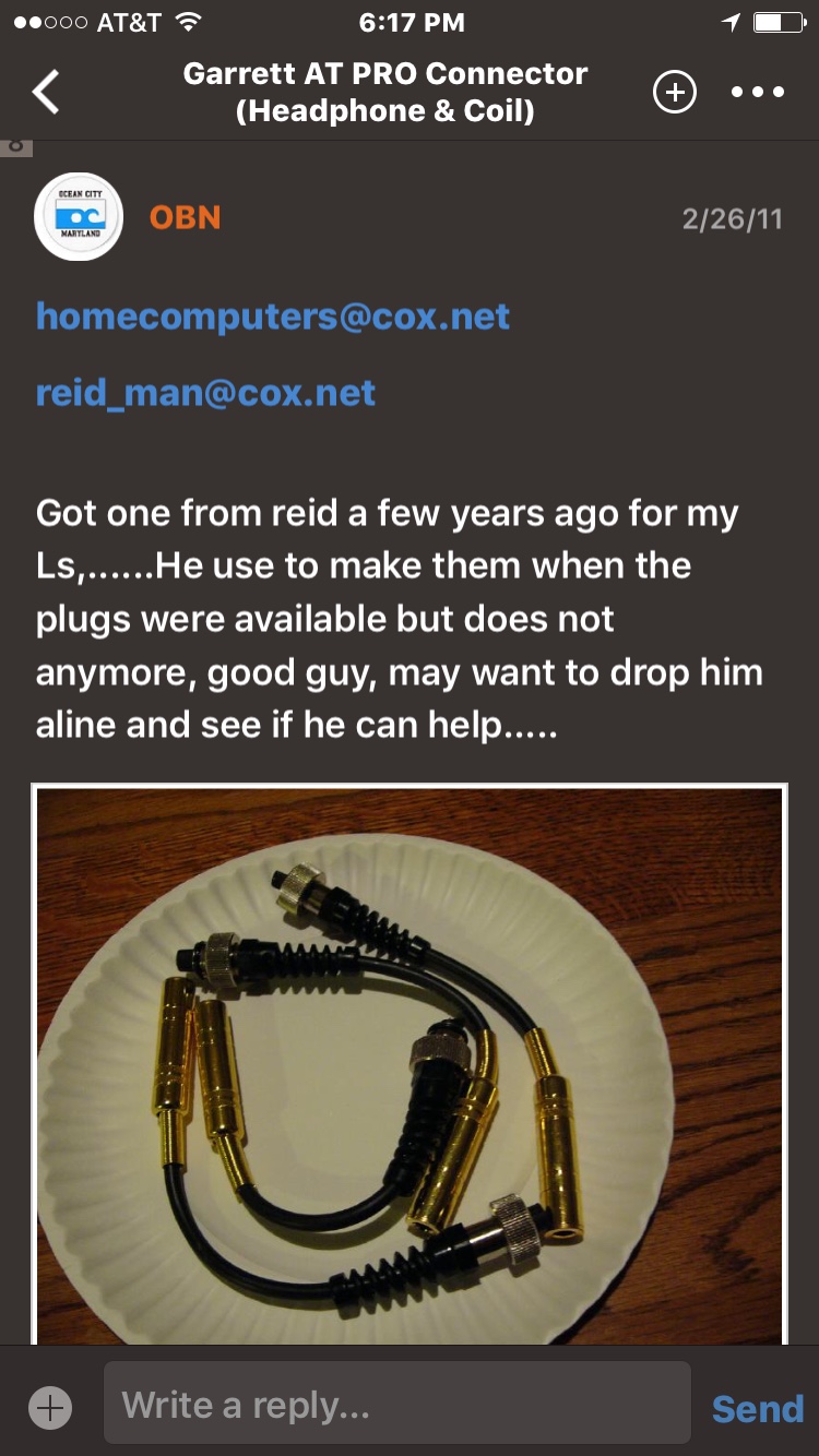

where could i find the headphone adapter cord?
Amazon has it for $36, with 'Prime' shipping.
Or, perhaps you can look into this:
