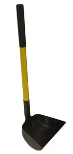

Sounds like a job for the BucketDigger. Its been available for about 3 years now at www.bucketdigger.com and its only $39.95, for now it only comes with a 24 inch handle length,, but you can modify it with a longer handle. If you do though, its tougher to manuver around, the 24 inch handle length is the optimum length for the most efficient use. And its built dam sturdy too. I've been using one for 3 years now and its holding up quite nicely. It also fits nicely into a 5 gallion bucket.

Hello GG and ScottC,
Ok, so forgive me for my ignorance, but how do you use these bucket shovels?? Is it similar to what jcazgoldchaser is showing in his photo? Do you put the open face down, and then pull the handle towards you??
