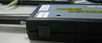

I watched him do it. The way he mounted it was he stood the vibramotoro on end and placed it just below the screw that holds the coil on and the hot glued it in place. Soldered the wires that were going to the speaker to the motor, then put another glob of anchor glue over the bottom of it. Doesnt appear to interfear with the coil at all being where it is. Plus, if I ever need to open it again, you dont have to worry about pulling the wires off. I'll get my camera from home and post some pics of it. He did an awesome job of it. And it works like a champ with the secondary sens adjustment we made. Was able to find a 1/16th" wide by 1/8th" long sliver of metal in hard packed dirt. Wasnt actually doing detecting stuff, just put it near the ground to see if there was something there, and there was, :)
Here are the pics. Modified the outside of the case
As you can see, we removed the red switch completly and covered it up, put a normal toggle switch on top where the light use to be.
Another angel
Internal shot of the switch wiring
Internal shot of the cell phone vibra motoro
A little size prespective. its a tiny tiny motor but damn it sure makes the thing vibrate a lot!
