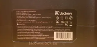

Hello. I need help finding a water pump/dredge that will run on this battery.

12 volt @ 200 watt is less than 1/4 horsepower. That's not nearly enough to run a dredge pump.
You need a much bigger power source. Look into gasoline powered pumps if you want to move mineral materials. Battery power is insufficient.

clay is right, not enough power. but, if you are looking to keep it quiet on the creek, and you have water
with a drop of 3 feet over 10-20 feet, you might google, (gravity dredging). i have done it and it worked
well. i would still be doing it but my back disagrees with it.

Look at a Honda wx15 series pump...
Quiet, good pressure for up to a 3-3.5" dredge,
especially with the right infinity or multi jet type setup......... it'd be hard to beat for a semi stealth, mid pressure. sucker pump.

be good for a bilge pump, run a goldcube or small recirculating sluice
12v shows 3.5 amp so 1200gph is 3 amps a 2000gph might be pushing it at 4.25 amps
it is a lithium so the amp hours might power a 1200gph goldcube pump 5 hours
a regular 16.8 amp hour, lead acid can only be discharged halfway before needing a recharge, so half as long run time.
