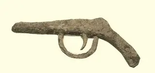

Hey guys,
Dug this pistol at the last DIV, mixed in with a bunch of Gardners, Ringtails, and Teardrops. (And a few Confederate buttons although not dug by me but I did get to watch my old man dig a nice little VA cuff) I tried like hell to find the barrel with no luck...I cannot seem to find a match for this anywhere. Checked all the books I have (admittedly not as many on guns as I should have in my arsenal I suppose) Also searched online to no avail...
I really like this piece a ton and would love to figure out what it is. Figured there's no one better at the gift of ID'ing things on the internet than y'all here!
Thanks a lot for your help!!

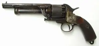

Please check this out and see what you think. I will be back tomorrow and tell you more about it. But I can tell you that out of about 20 comparisions I tried, this was the only one that even came close to being a match. I printed the pictures first and then cut out the relic image and taped it to the picture of the revolver. After that I scanned and saved it. The colors are weird because my printer is running out of ink. The trickiest part was getting the scale right. And the final touch was to outline it in red.
I realize this is not conclusive. But I also know that corrosion can play tricks on things.
Who can tell me what type of revolver it is?
And don't forget to click on the images to enlarge them. Once they're open you can click back and forth from previous to next.

The shape is right, but if it is part of the frame of a revolver, where is the upper part with the recoil shield behind the cylinder? The frame is one piece and would not separate.

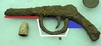

Agreed the shape is right but I outlined in red where I think the trigger guard would end.
We may have to wait for the cleaning and preservation to see whats under the crud.

Wikipedia Link: LeMat Revolver - Wikipedia, the free encyclopedia which includes ...
Civil War use: LeMat hoped to market his adaptable revolver as a primary sidearm for dragoons and other mounted troops. He entered into a partnership with P.G.T. Beauregard (at that time a major in the U.S. Army) in April 1859 to market his handgun to the U.S. Army. Beauregard, besides being LeMat's cousin,[SUP][1][/SUP] was one of the first U.S. Army officers to resign and join the Confederacy.
When war broke out LeMat received Confederate contracts for the production of five thousand revolvers, and plans were laid to manufacture the gun abroad and then import them into the Confederacy, which lacked the necessary facilities to produce the weapon locally. Confederate gun runners were able to slip shipments of the gun through the Union naval blockade and it is estimated that about 2,500 made it into Confederate service.

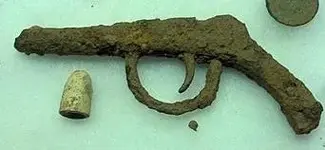

The rusted relic (for the 10th time) Lol
Original Patent No. 15,925 ~ Oct 21, 1856 ~ Painted red to illustrate long portion of guard. There are hidden features in the grip that cannot be seen. The blue arrow points to the "fancy" part.

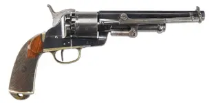

Multiple variations from LeMat book. This is the largest image I could create. Particularily notice the revolvers without the fancy guards. I wish I had a copy of this book.
Variation ~ Without fancy guard. Sold at auction for $69,000.00

Homework assignment for dilligent students ... consider some of the most common Civil War revolvers.
Click to enlarge and read.
The three most distinguishing features are ...
1. Red ...... The approximately 2" inch long forward portion.
2. White ... The horseshoe shape guard portion.
3. Blue ..... The approximately 45' degree angle of the grip portion.

And your timing couldn't be better for your reply. I sent some more pictures of the relic and Frank Cutler had this to say after seeing the one of you holding it with your finger on the trigger ...
"I really believe its a LeMat. The 3 lower bullets are from a rifled musket. Two look like .58 cal and the other .577 cal."
Frank
