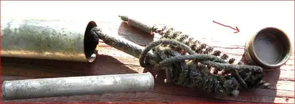

Looking forward to seeing the photos, to help you identify your brass bore-cleaning brushes. Meanwhile, here's a photo of one often mistaken as civil war era, but t'is actually a Model-1903 Springfield .30-06 rifle's bore-cleaning brush, with the kit it came in.

CBG-The "Enfield cleaning brush that I found a couple years ago looks like the (TOP) brush in the pic, you posted [ no bristles] of course .
Did the Enfield rifle have a similar type cleaning brush?

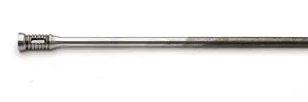

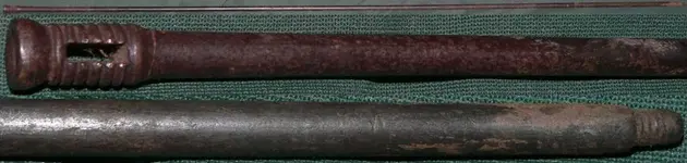

The civil war era Enfield rifle did not use a bore-cleaning brush. Instead, the "business end" of the Enfield rifle's ramrod had a slot for a small cloth to fit through it, for cleaning the rifle's bore. See photos below.
