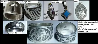

Where do jewelry targets come in...
Gold...from iron up to zinc and even into dimes or quarters if it is large/thick and/or pure like 22-24k.
Silver...larger rings the same numbers as dimes up to silver dollar size...70's-low 90's on the big ones.
Smaller rings could come in at zinc or lower...smaller pieces like earrings and pendants could come in below the dime area too.
Chains, no matter what they are made of they can come in anywhere from iron to the dime quarter area depending on size, thickness and whether you hit a clasp and the size of that clasp.
Silver chains in the pic below.
I have never yet come across a silver chain that came in any higher than zinc.
Some examples below.
All targets were found at these numbers with the F2 or air tested with the F2 later.
