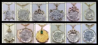

from 1998 cataloge :o
Great ID dagfoto. My first question also would be why is it dirty? Are they hiding something? Are they trying to make it look old or dug out of the ground lol?
I agree its most likely one of the Atocha replicas.

Re: Help with ID & possible value please
those early ones were gold plated .. the gold wore off after awhile.. He only makes solid gold bezels now..
was probably sitt'n around in the junk box "toning" .. before the sale ,,
It was a popular style.. I use to sell alot of them in a store I had..
Dagfoto nailed it...it is "430D" in that catalogue. Also, notice that is "the cross of Jerusalem with no ornate quatrefoil". The authentic coin was 1688.
