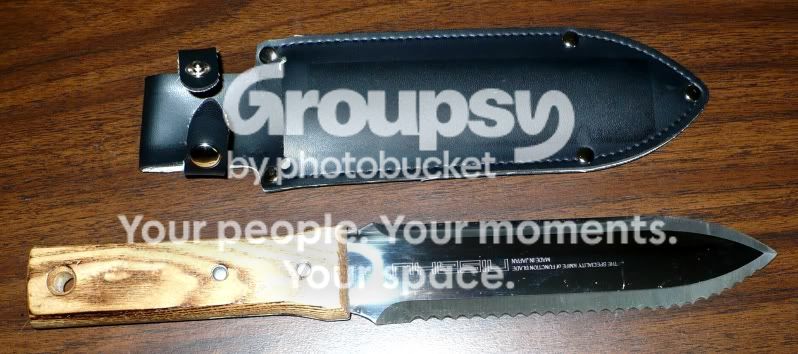

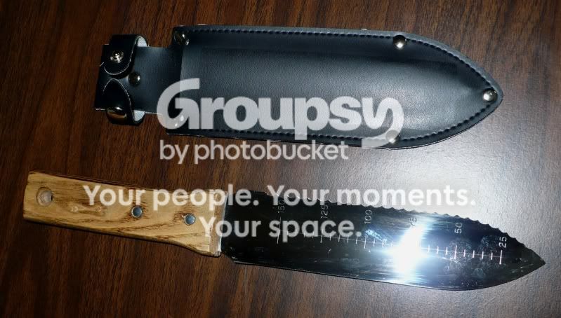

My Chinese knock-off Lesche digging tool/knife was starting to bend when I would pry out a plug. Knowing it would not last very much longer, I went to the web to find a good deal on a Lesche digger. In the process, I spotted a Japanese Hori Hori knife (not Hari Kari, ;D) used for gardening, bonzai plants, digging and metal detecting accessory......thought I would give it a try for $26. It came today, the blade is very stout and 'hurt yourself' sharp! Haven't had a chance to try it out yet, but, it seems to be just what I wanted for digging plugs. Will let everyone know how it works out.....if it doesn't work out, may have to buy the Lesche anyway:

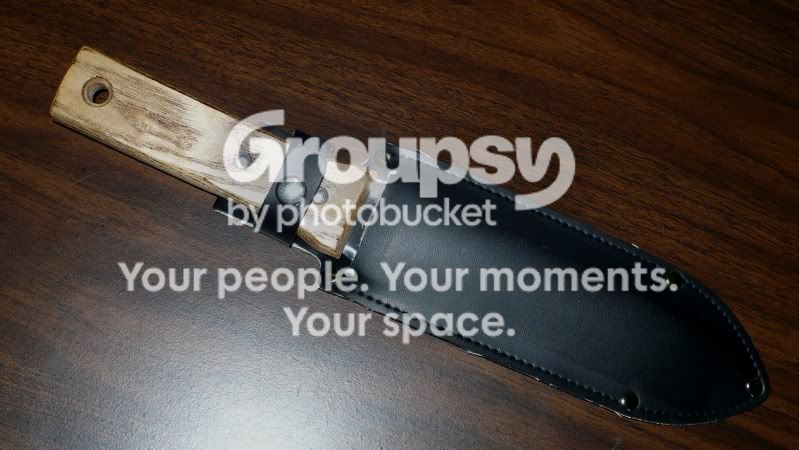

Tool/knife in sheath (sheath is not leather, it is heavy vinyl backed with cloth):
Concave side of blade, note serrated edge on one side and straight edge on the other (VERY sharp!):
Convex side of blade:
This thing should be ideal for cutting a plug, especially, after I wrap the handle with grip tape. I am using the sheath that came with my Kellyco cheapo, the sheath that comes with the knife does not have a large enough hole to accommodate my tool belt. Of course, I could have 'rigged' something to carry it and will eventually have to, as I am sure this knife will cut through the nylon sheath before long.
That's a serious digger! I have been lookin at something similar made by treasure wise. Be careful with that beast. That serrated edge looks like it could ruin your day very fast. I would be fashioning some sort guard for the blade.

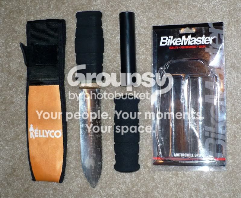

After a number of hunts using the Hori Hori knife for a digger, I remain most impressed. I have not had to dig any bone dry, rock hard, red clay as yet, but, anything short of a backhoe has trouble with that! As much as I like this digger, the handle still left a lot to be desired. Today I went by one of the local motorcycle dealers and purchased a set of foam grips. I couldn't find the ones I had in mind, however, I thought I could make these work......and they did.

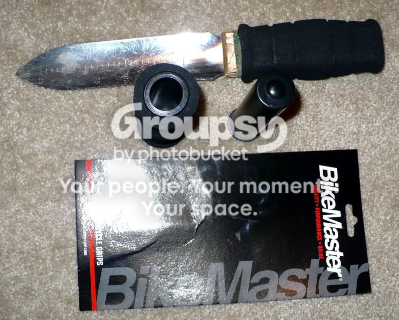

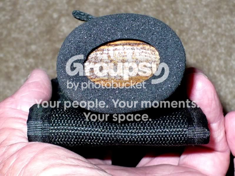

The foam grip is mounted on a plastic tube that is made to fit on a handlebar. I removed the foam portion by rolling it from one end to the other.....much like the reverse procedure for a 'prophylactic' device. (couldn't think of any other way of explaining it). Anyhow, with the foam grip rolled into a ring shape, apply some heavy dish soap/water mix as a lubricant to the exposed portion of the 'ring' and the end of the knife handle. CAUTION!: For the next step, the knife should be held in a vise, or inserted between the boards of a picnic table, or, at the very least, tightly wrap the blade with a number of layers of cloth and tape in place. You do NOT want your hand slipping down on the blade!!. With lubricant applied, begin pushing the foam 'ring' onto the end of the handle. This will be difficult, but, it can be done with some effort. I made sure to leave a little of the grip extending past the end of the knife handle to provide a pad when I am applying pressure with my palm. Once the foam ring is started in the right position, simply wrap your fingers/hand around the ring and push downward, unrolling the grip onto the handle of the knife. The end result is a wonderfully padded handle.
Bike Master grip kit with one grip already on the handle of the knife:
This pic shows the end of the plastic tubes, one with the foam still on and the other one with the foam removed:
This shows the end of the knife handle down inside the foam grip, providing some padding for applying pressure:
My application would have been much easier had I removed the grip tape from the knife handle before installation of the foam. In fact, with just the foam grip properly lubricated, it could probably be worked onto the handle with some pushing and twisting (WITH THE BLADE GUARDED!). I actually used a product called Ruglyde, which is a rubber lubricant used for mounting tires. It turns tacky after drying holding a tire bead, or, in this case, the foam grip in place. I didn't fashion a blade guard, even though I probably should have.....I'll just be careful in the meantime.
