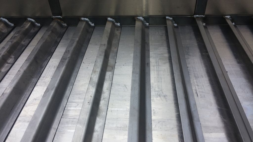

I got the sluice and riffle trays back today. They look good, I'm happy with them. I was hoping they were going to have them plated as well but I'll just undercooat them.

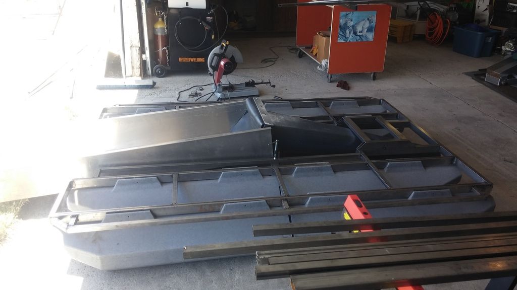

2 days ago I was able to negotiate with my land lord to stay at my current home for another week or two and pay rent on a daily basis. I went ahead and ordered 4 more floats straight from prospectors plus and continued to build my custom frame. They were supposed to call me and let me know whalllt the shipping would cost before sending them out. I received an email from them yesterday stating they had shipped the floats and the shipping cost is $200. The floats from them (the manufacturer of the Brawn Floats) was $650 plus shipping puts them at $850. Yet I was able to buy the first set of floats from Cabelas for $600, with free shipping other then a $55 oversize charge, for a total of $655. Why didn't I order from Cabelas? They are out of stock.

those are some nice riffles, still have to get some made for my 5" build.

The ruffles came out well. They are made out of a thicker gauge steel to prevent bending/flexing when large rocks roll over them. They ought to work well.
Here is another picture, I didn't realize I posted the same one twice.
Nice looking riffles. Could you provide the dimensions for them with the ankles they were bent at.

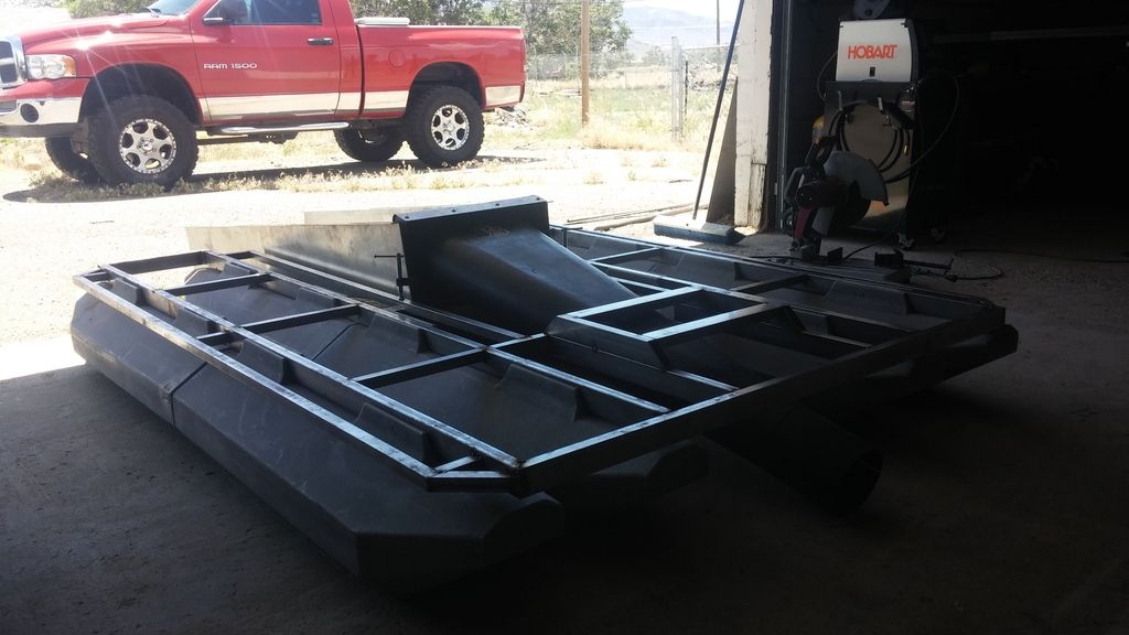

Got all moved in down here in Nevada. Back to work on the dredge. Hoping to have it finished by the end of the week. Dredging season dowesnt start on my claim until June 15th so I'm cutting it close. Dredge is looking good though.

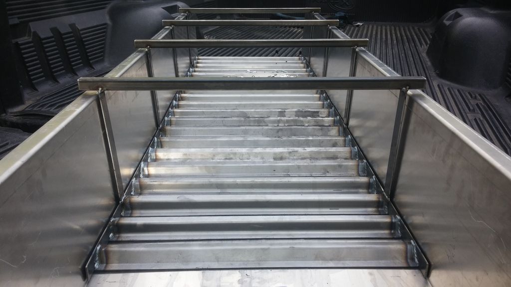

Dredge is just about done. Just have a few small things left to put together. Working on installing the clamps for the riffle system but trying to decide if I should trim some length off of the sides of the sluice. I currently have 9" tall sides on a 20"x6' sluice box. I'm pretty sure that is a bit more then I need. I'm thinking more about 7" sides for the lower 3/4 length of the sluice. That will leave me with 6" of side height above the riffles.
Any suggestions on side height? What are the sluice box's on keene and proline 6" dredges? The keene 6" I had a few years ago d definitely wasn't 9" tall but I don't remember the exact dimensions.

I would have went with twin engines and pumps but I already had 2 New 16hp engines and a keene 3x4 pump to use.
As of the barrels for the floats, I probably would have went with those but the company who I ordered my floats from wouldn't take returns so I've got these laying around to use as well.
