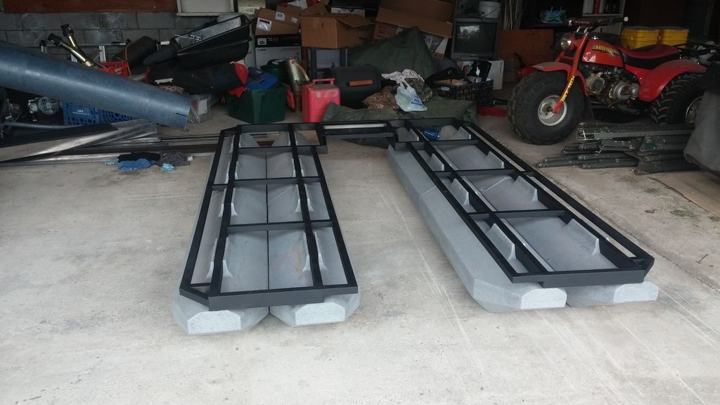

I do have a worm gear winch I was going to use for adjusting the slice angle but decided to hang the slice by chain at the end of the frame. I'll be able to adjust the sluice in about 1/2" increments. The front of the sluice/flare sits on an adjustable crossmember that slides along either side of the frame to adjust weight distribution.

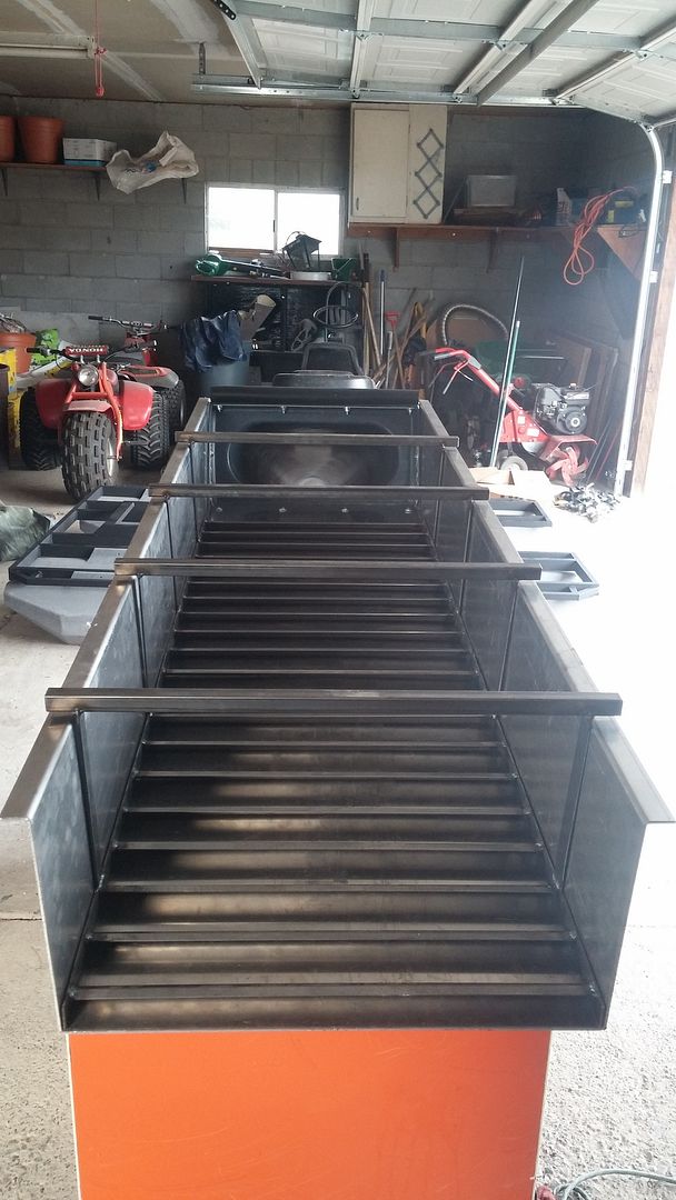

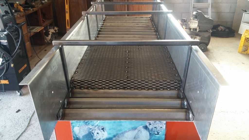

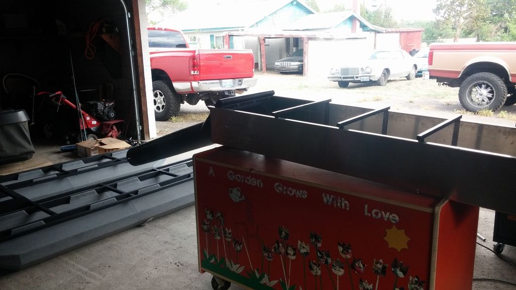

Quick little update, sluice box is about 95% done. Just need to finish up the classifying section and figure where my clamps have gone so I can mount them up.
Shop is a bit unorganized right now, too much dredge parts laying around.

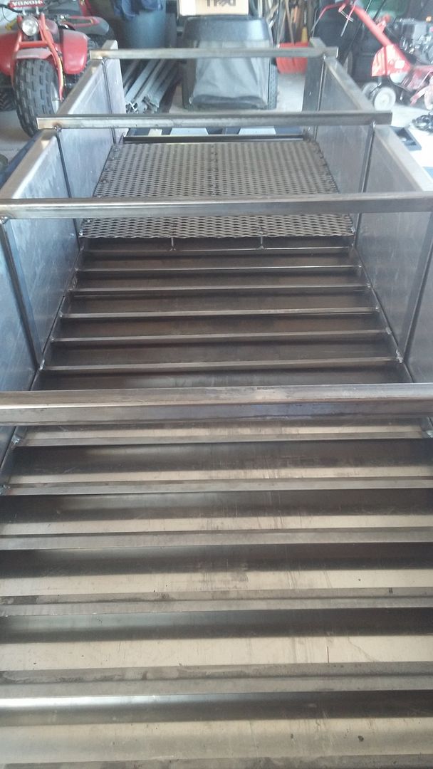

Riffle system is done! It's too damn got today so I'll find the clamps and mount them tomorrow morning.
Must be into some big gold. That's a lot of riffle. No UC? How much for those 3 wheelers? They look new.
Decided not to go with an undercurrent as I didn't particularly want to fab one up. I also don't have very much fine gold on my claim. Mostly chunky rough stuff. I've got some large expanded under the screen followed by 2 riffles at the last portion of the classifying screen. The screen is 24" long with about 2p" of large expanded over miners moss. The rest of the sluice will be carpet.
