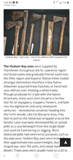

I know it's really corroded but I found this metal detecting the other day. It was really deep below the plow line. I've found arrowheads at the same site but all I know about the area is that there use to be a big house there already in shambles in the early 1900s. That's according to a 90 year old man that owns the property. He said it use to be a school house. I have found a 1899 indian head penny there too. PXL_20210115_115811240.webpPXL_20210115_115820107.webpPXL_20210115_115803817.webpPXL_20210115_115752249.webpPXL_20210115_115743025.webpPXL_20210115_121910461.webp
Fur Trade Axe. Might be one of the pipe variety... pretty cool MD find!
Just from what I see in the picture is I don't see a pipe hawk and the hole for the handle looks wrong for a trade period axe. I've never seen a trade axe with a hammer head on the other end from the bit end. It would help to know what state/area it was found. I would think it's colonial. JMO

Click on the enlargement of the pic and I can see the built up corrosion/decay has closed the socket hole. Though looking at the pic one can see almost how the folding of the plate/iron is now showing.

I’ve been trying to find the pics I have but that really is neat. I think cleanup gently and see.

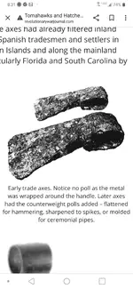

The pic you had with two, the other head sure looked like roofing tool but if that is a bowl instead of a hammer. IDK
Jen Taylor the arrowhead and author, use to have a link that was full of good info about trade axes but I can’t locate now.

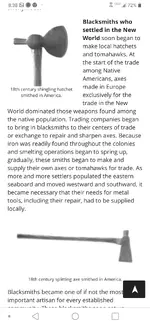

Then too , blacksmiths and common folk with a forge produced tools to the creator or customers desires.
I agree the handle hints more of an axe eye vs hawk. Not uncommon in the East at one time. And of course design can travel beyond a region it started or was popular in.

I never saw shingling hatchet with a round poll, nor one made of wrought iron. nor one that had a blade flair both front and back. It's most likely a tomahawk with hammer head made by a blacksmith from an old rifle barrel. Really early and could have been carried by a pioneer farmer, trapper or even an Indian. It would have been perfect to carry while trapping. I wouldn't try electrolysis as there may not be much left of it when you finish.
My vote is a modified trade axe - a "Hammer Poll Axe", with that very pronounced "poll" - the hammer-part of the relic...!
A variety of that, might have a nail-puller, in a shingling hatchet
The axe-maker's book said that Trade axes were made for trade with Indians, so no wonder tomahawks were to later resemble the Trade Axes...!
