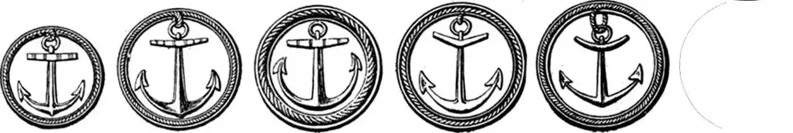

Your button shows four important ID-characteristics:
1- Its anchor lacks the "fouled" rope usually seen on US Navy buttons.
2- The anchor's top-bar is curved.
3- The anchor is connected to the inner ring by two loops, not just one loop.
4- It SEEMS to not be made of pewter, but instead looks like brass or bronze.
Those characteristics cause me to think it is a 1790s French Navy Officer button. See the button on the right in the diagram below, from a very-extensive book on French Military buttons (titled "The French Uniform Button) . That button is reported to be made of bronze. The book is viewable online, but it written in French, so you'll need a translator-program to read it. To view the diagram (and info), scroll about 3/4ths of the way down the webpage, here:
http://detektorysci.pl/guziki-napoleonskie.html#bookmark293
It leads me to suspect that the curved-top, no-fouled-rope buttons shown in the Albert book as button NA-2 is an American cast-pewter copy of the bronze French Navy Officer button.
The next buttons in the Albert book, NA-3A and 3B, are listed as "French style" US Navy buttons. However, the exact-same NA-3A button (which is made of brass/bronze) is shown in the "The French Uniform Button" book's section on "Military Naval and Colonial" buttons as being an "Old Regime" French Navy button, dating from 1772 to 1789.

Looks good to me. Cast pewter, but slightly different than the book shows. I've never seen a French one that wasn't brass, or didn't have a turret shank.
