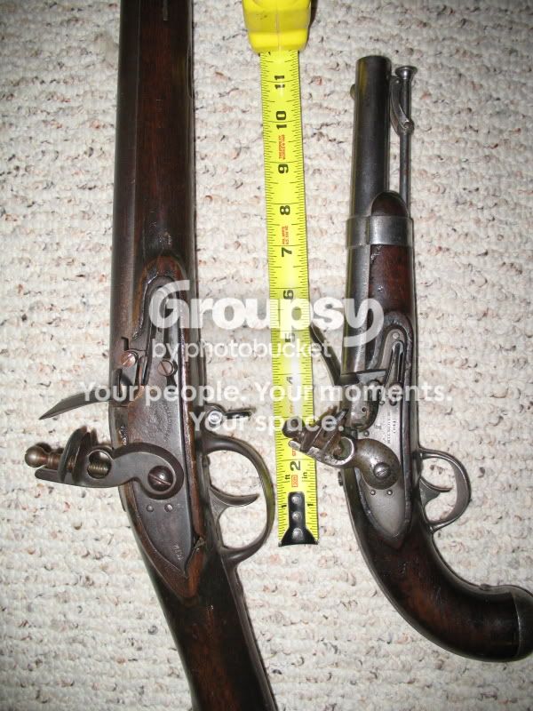

Looks like a nice cleaning job. Also, because of the size, it looks to be a pistol lock. Here is one more pic with size comparison.
