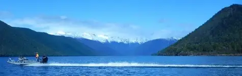

Here,s a Jet boat dredge
Aaahh yes the old Mk1..... Mk 2 was launched two weeks ago with refinements learned from Mk 1.
Still have another weeks work to go, before I am ready for the (down under) summer season...
No details or detailed images will be posted of Mk2 as I am getting inquiries asking if I would go into production with it... so there is a little intellectual property to protect.
However to wet your appetites ... an 8 inch dredge that does an easy 30kts designed to access difficult river gorges.... the design would work for anything from a 4 inch to a 10 inch dredge
Just imagine putting your wet suit on in a warm shower in the morning launching and boating to your claim, dredging the taking your wet suit off in the shower at the end of the day... that is what I do.
