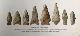

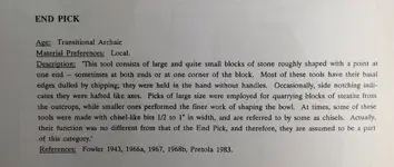

Edit: here is an example of a poor New England lithic, argillite of a type that is argillaceous slate(in contrast, Pa argillite is argillaceous shale), showing the original cobble cortex and a minimum of reduction or flaking. In this instance, it's actually a finished piece, as this is an end pick, which was a tool used in steatite quarrying in southern New England. But, I have to imagine it could easily be judged as "just a rock" if one is simply not used to seeing lithics as poor as this....

Yes, it's New England argillite, either Barrington Argillite, or possibly Nantasket Argillite. Our argillite is actually argillaceous slate, and in southeastern New England, it is the second most common lithic used, after quartz. The artifact in question, the one I illustrated, not the one that started the thread is an end pick....
This is so obvious, kinda frustrating actually trying to convince people who likely have no experience with New England argillite, and perhaps no experience with quarry tools made quickly with just basic reduction of a cobble. This is clearly bifacially reduced, with obvious cortex or rind of the argillite cobble visible on both sides, and showing reduction of that cobble. You may say you make these every time you do certain jobs, but this one is a few thousand years old, and employed in a soapstone quarry located close to the farm from where it was found. These are crude, quickly fashioned tools; don't expect to see pressure flaking or any refinement. I do expect experienced eyes to recognize argillite that shows obvious bifacial reduction. You likely just lack that experience, but myself and all my friends who collect here have no problem recognizing what is commonly found here. And, judging from the new photos by the OP, his artifact might have been intended as a heavy duty tool as well.

BTW, from the size of that thing, I would not be surprised if it were an end pick as well. See the description and illustrations of end picks I left above in an earlier comment. They were used in tool production, as well as steatite quarry work, and come in both large and small sizes.

I dont believe it's slate. It looks like one of our regional rhyolites, but I am unsure which variety. The end pick I showed is argillite of the argillaceous slate variety. There is a chance your piece is a brownish argillite, as some Nantasket Argillite trends in that color, but most of my experience in Rhode Island is with Barrington Argillite. I did show your piece to several collector friends from southern New England, and they recognized it was an artifact, not a geofact. People should be able to recognized the reduction from the cortex showing in the center of your piece, but we have to allow that even highly experienced collectors, if they are not used to finding crude tools from poor lithic material, may miss the fact that it is artifactual. But, you can be assured there is no New England collector with experience who would not recognize it.

I'll take the opportunity to provide an educational moment. Here, argillite in the form of argillaceous slate(and closely resembling slate from the Carolina slate belt) was used mostly for flaked stone tools. But, it was also not that uncommon for ground stone tools. For instance, here is an argillaceous slate adze from RI:
And "true" slate as well, was long used from the Middle Archaic through the Late Archaic in New England. Ground slate points are common on sites associated with the people who made Otter Creek points, and particularly common on Maritime Archaic sites in Maine and Canada. Here is a ground slate point found in Providence, RI years ago...
