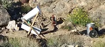

so my crazy drywasher is get harder to move after i set it up.so iam thinking of making a small lite weight one using pvc and a 12volt motor with a offset weighted fan,so i can do some testing,will a 12volt motor work ok with a weighted fan.i just dont want to use a leaf blower.or handcrank.i also tried hauling buckets ,not for me

I bought a Thompson with the 12 v puffer hand crank combo. Its "light"
a 12 volt air driven unit is probably not a real option... your really asking is there a good battery powered leaf blower that will last long enough for me to actually process?
The answer is no. If your wanting real portability. And run Time.
IMG_20190528_150510 (1).webpi build this one,but hoping to build a small cheap one,just for sampling.thanks for the input.

View attachment 1770129i build this one,but hoping to build a small cheap one,just for sampling.thanks for the input.

If it were mine I would add wheels and maybe power them with one or both of those large 12V motors already there.
GG~
we think alike.i have thought about that.but what is holding me back is getting it all in my suv.my dog said nothing goes in the back seat with her. iam not ready to get trailer yet.
thanks brad
