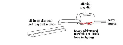

Next, your pictures are super and you came up with some very nice nuggets and the work site photo looks interesting, looks like you have a wagon or wheel barrow for a safety catch basin. Also some sturdy pipes for the water supply! I do not want you to give away anything about your site but if you can explain a little about the site, like are you pumping water from a source or is it a captive system? Thank you for sharing your fun with the rest of us.

The system is a closed loop system the water is stored in a long settlement pit and is pumped into a 5 gallon acid type barrell (side cut out) with inlet for water on on end and the other end has the 4 inch pvc coming out and goes to the sluice.
The barrell acts as a mixing and dirt clod breaker ( hard pack ) , it also acts as a catch for the large nuggetts.
The 4 inch pvc is about a inch of the bottom ( side - see sketch )
