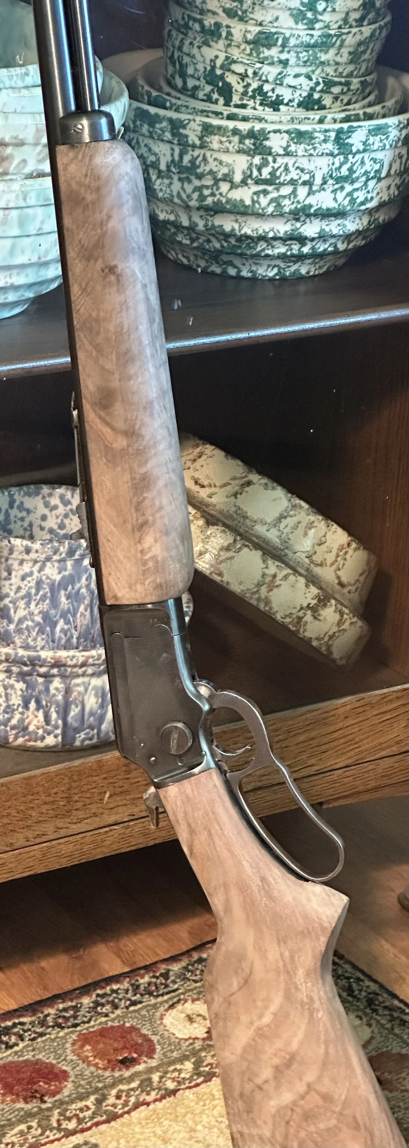

My grandfather bought this Marlin new in 1948. My dad inherited it in 1970. I was in high school then and took it squirrel hunting. I cleaned it when I got home. The two main parts of the receiver were never properly fit at the factory. You had to bang on it to get it back together. I banged it way too hard and split the butt stock in two. 😫 My dad was not amused. He glued the stock back together. Then it’s dads turn to screw up. Instead of taking it to a gunsmith to drill and tap receiver for scope, he took it to work and had a tool and die maker tap it. He was off in his drilling and the scope wasn’t aligned with the bore. Dad passed in 2011 and my brother ended up with the rifle. He contacted me and wanted to restock it himself. He had never done a stock job but was very confident he could do it. I sent him a killer set of semi finished walnut and he tried and failed. He did okay until he sanded the butt when it was off of the rifle and took off too much wood around the wrist. I told him STOP already, and told him I’d trade him the Marlin for our Stevens single shot. The Stevens was our rifle we both learned to shoot with. I restocked it and put a good scope on it. He agreed and I now have the Marlin. First thing, it will go to gunsmith to get receiver parts to fit correctly. I’ll put plug screws in the badly drilled holes and use open sights. Then I’ll restock it. I don’t know if I can salvage the butt stock somehow. I’ll eventually get this thing lined out!
That new stock looks great
I’m hoping I can salvage it. He said he took off too much wood. I haven’t test fit it yet. I just got it Thu. I cut that walnut just a mile west of my house in 2016. Not very many have that much color.
I was able to finish fitting the butt. One small area my brother messed up but I can live with it. I ordered a recoil pad and that will be the next step on the butt.

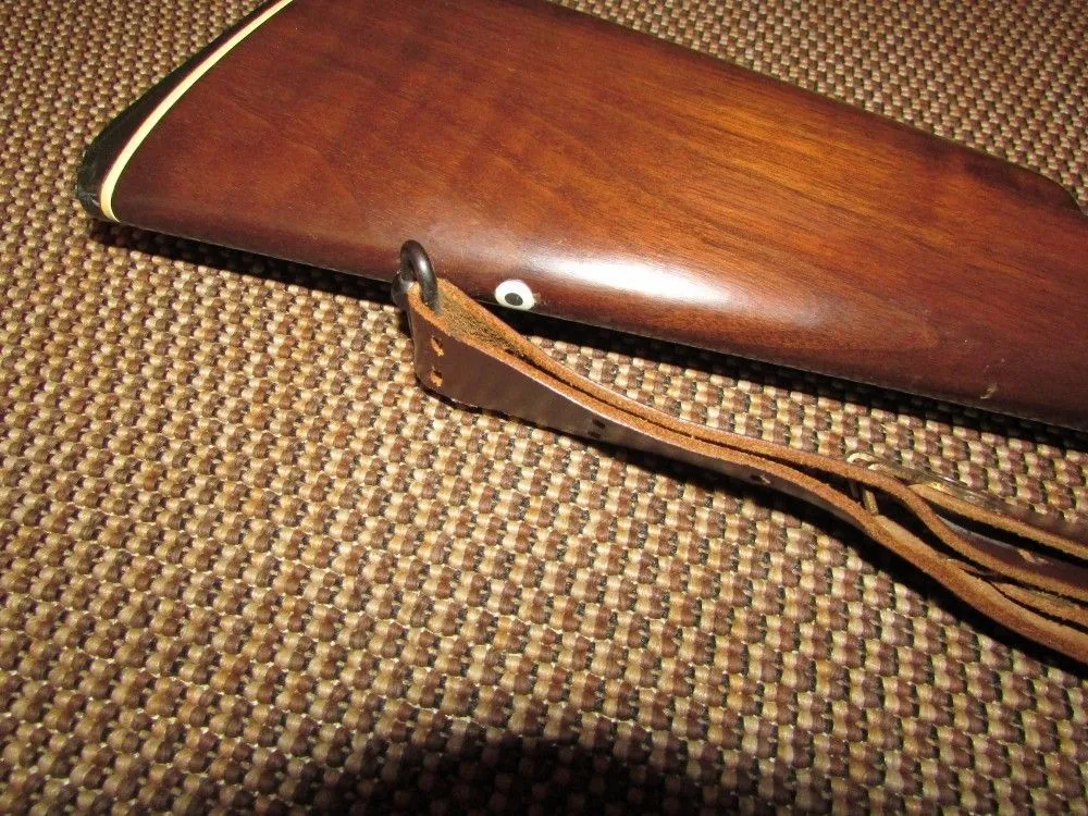

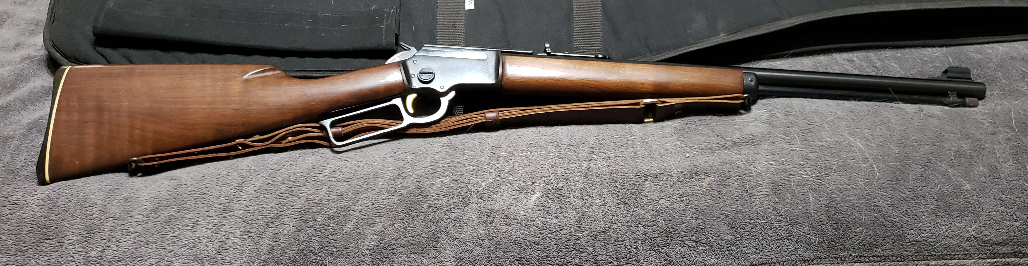

Did the 39A have the bullseye symbolizing it had a walnut stock like the 39M?
Plus did it have the white spacer on the butt plate? Dont know the reason/meaning for that, other than decorative.
My 39M showing what I'm talking about.
Looking good, going to look awesome when done.

Mine is from 48 and has the bullseye. I’ve thought about trying to remove it from the broken stock and putting it on mine. Kind of a Marlin trademark. No white lines on mine. Now that Ruger owns them I doubt the 39 will come back. You never know though.
I cut 1/2” off the butt to make room for the 1/2” thick pad. Centerline marked. Pad will arrive tomorrow. Found a small rotted spot I dug out. Very lucky it’s not on outside of butt.

It took me a couple of hrs to mount the pad. It was more difficult than usual because pad was slightly warped. Top and bottom end both slightly out. Pachmayr used to make the best pads. Probably made in China now.

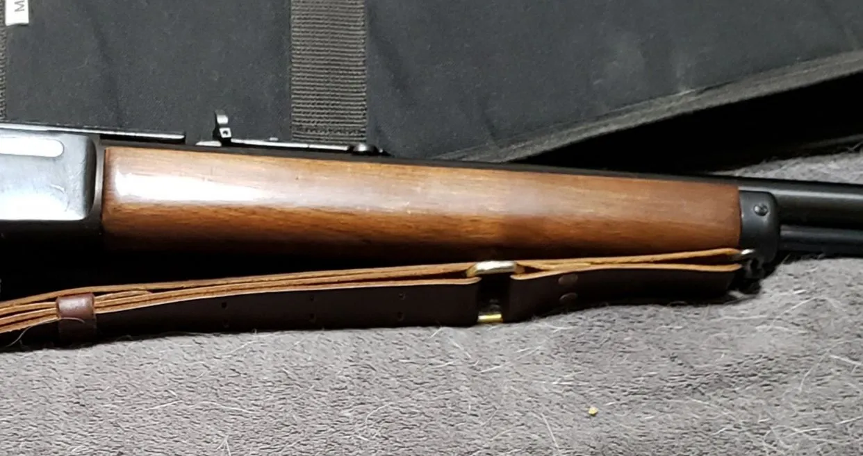

The forend is all fit. This forend was a tricky one. Around 4 hrs fitting it. Next I’ll slim it down. The factory forend was too fat to begin with and the guy who duplicated the stock for me left even more.
The forend is all fit. This forend was a tricky one. Around 4 hrs fitting it. Next I’ll slim it down. The factory forend was too fat to begin with and the guy who duplicated the stock for me left even more.View attachment 2173026
They sure did leave you a chunky handguard....WOW. Guess its better to have to take some off, as you can't add some on.
I like the dimensions of your forend. That’s what I’m going to shoot for. I think about the time they added the white spacers they updated the forend and thinned it down. You can see on this pic of my ‘48 model with the factory wood how thick it is compared to yours.
