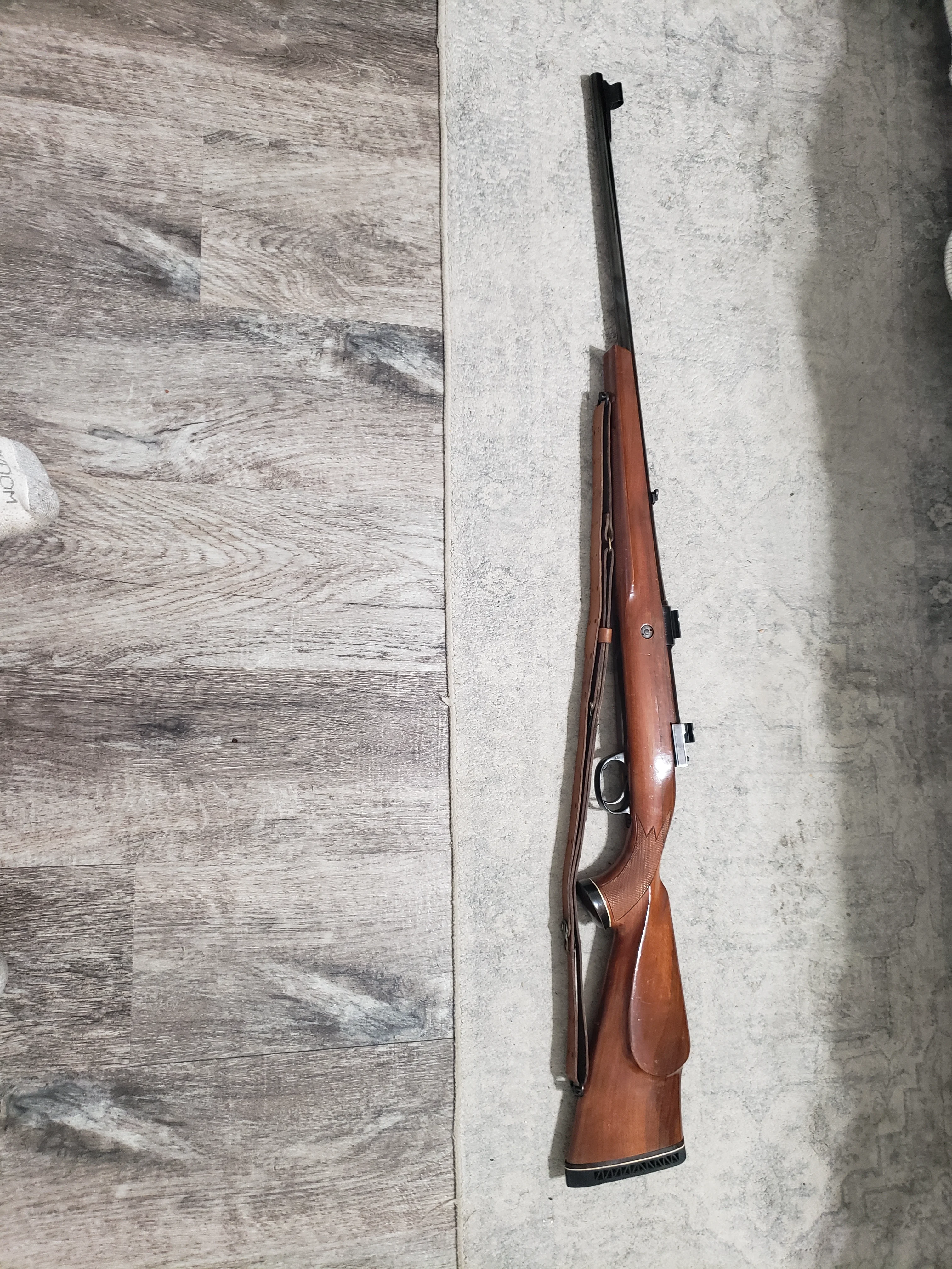

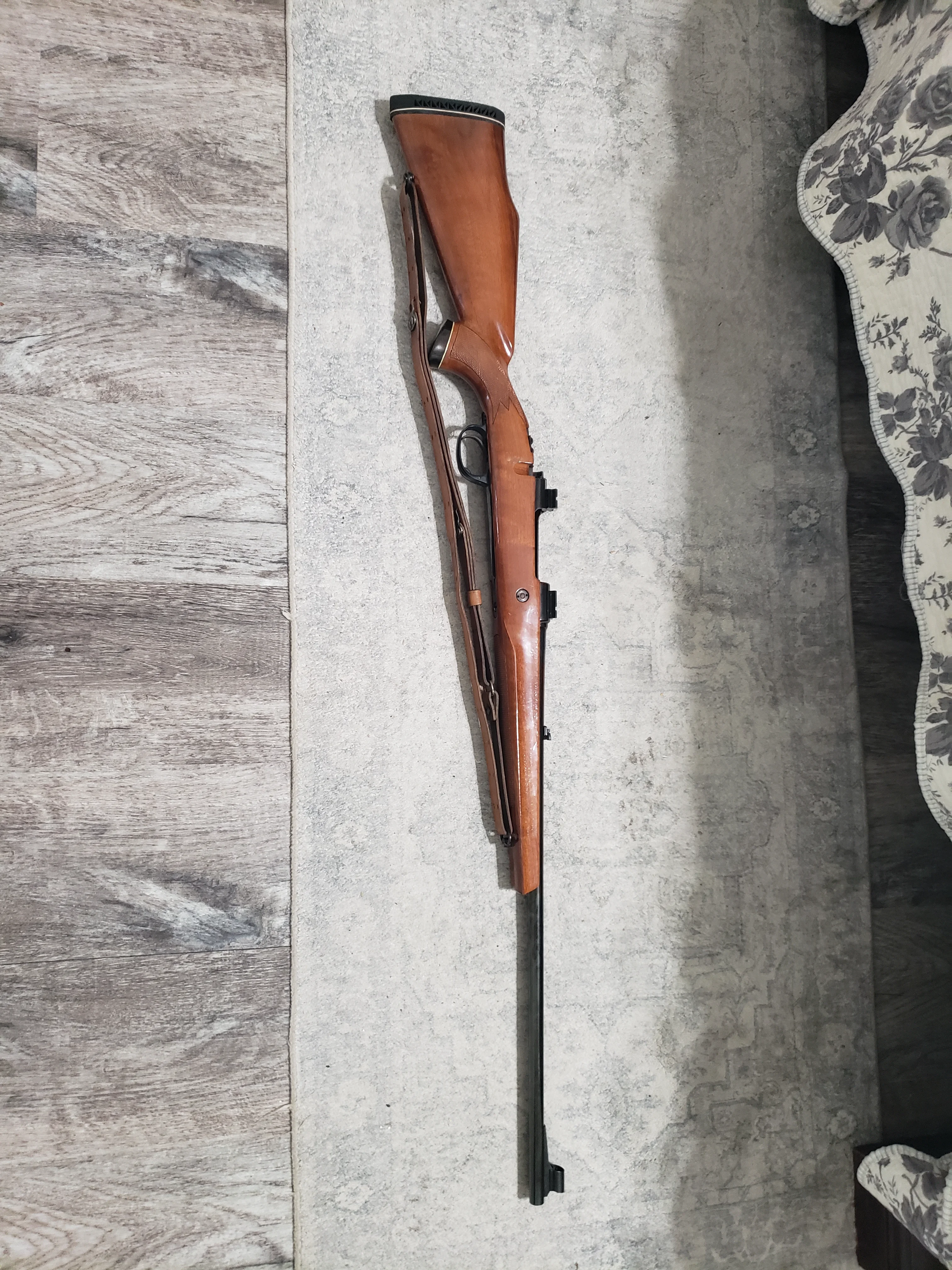

Cleaning up a English made Parker-Hale rifle in 270 that belonged to my dad and is now going to my oldest son.
My brother inherited it along with 2 other rifles, and I inherited 2 rifles and a pistol before our father passed.
This rifle was made in 1973 based on the Y B date code. It utilizes a Spanish Santa Barbara receiver, and Belgium FN Herstal Mauser bolt. It sits in a English or European Walnut Monte Carlo stock.

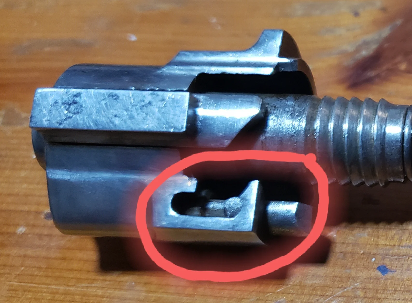

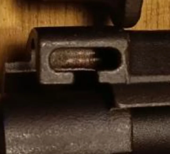

Upon getting the bolt broke down we discovered that the C channel on the bolt shroud that holds the plunger and pin had broke at some point in the past. A replacement bolt shroud is on order

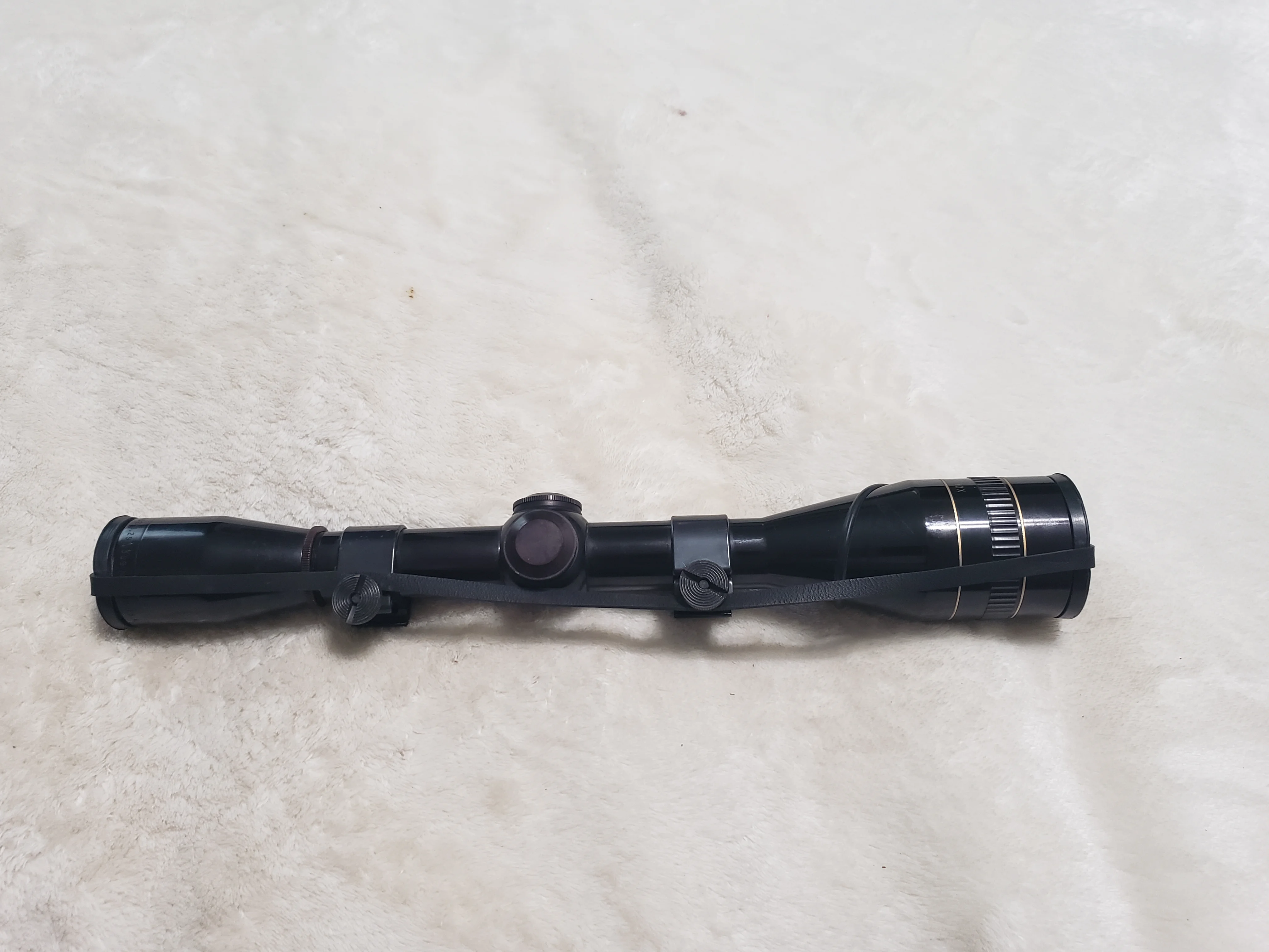

The scope with it, is a pre 1974 Leupold M8 10X AO. Its been with the rifle since my dad bought it sometime between 75-77. Still has crystal clear optics.

Rifle sans bolt and scope.
Scope.

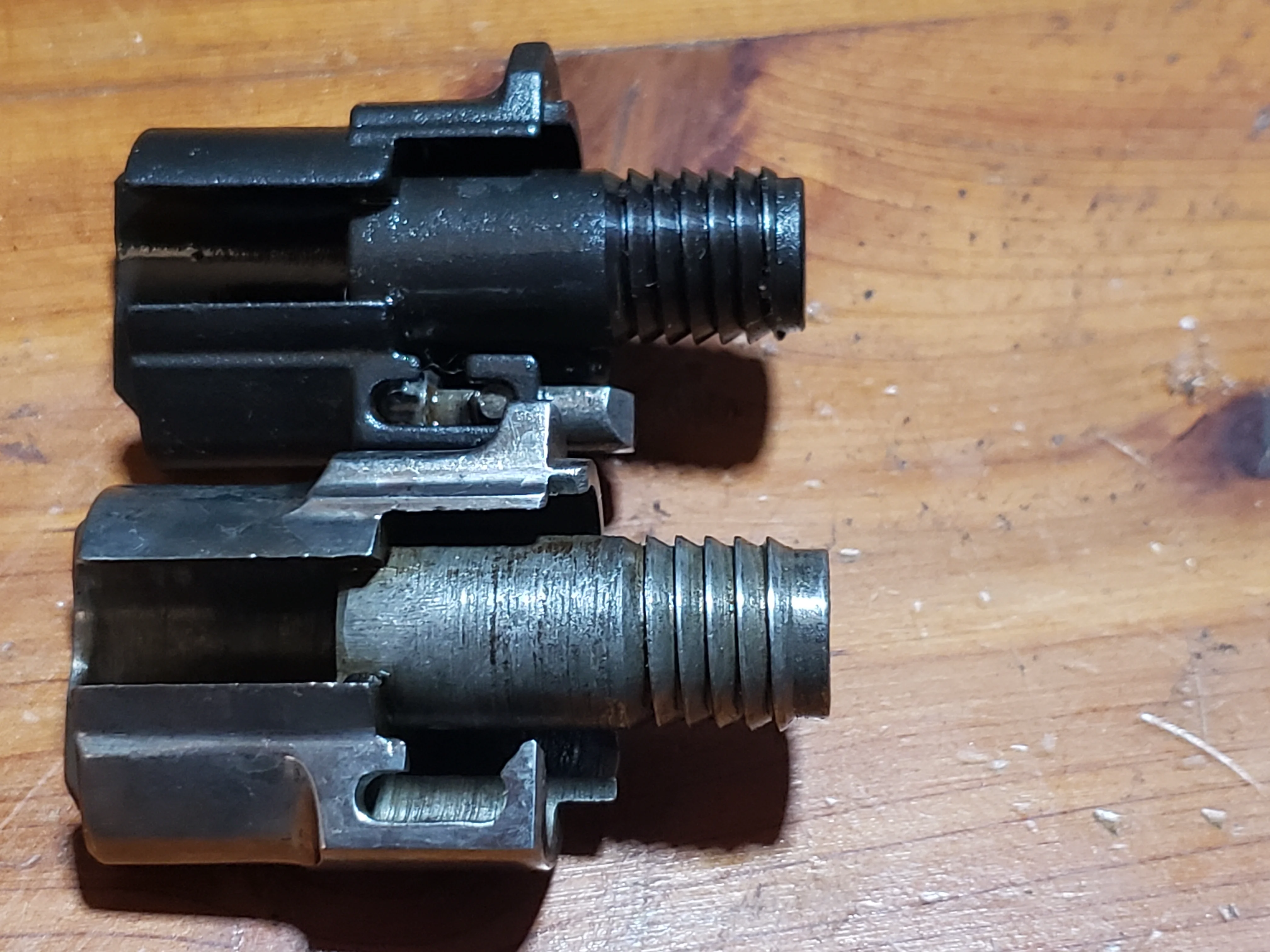

Bolt shroud showing the damage. The right leg of the C channel is MIA.
A bolt shroud showing no damage, to give an idea how much is MIA.
Sarge..what's the barrel length on that? Looks like it's longer than standard...26", maybe?
Believe or not 23 inches.

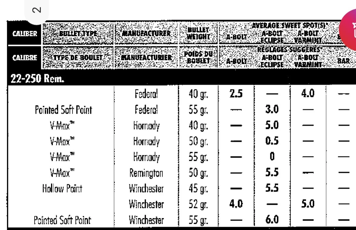

Supposedly the BOSS brake is adjusted in or out to find a sweet spot in the barrel harmonics based on barrel length IF I remember correctly.
Kind of fits in with what I’m told occurs as you adjust the distance between the ogive and the lands of the rifling (bullet jump). Apparently the accuracy if affected in a cyclic manner where as if the good accuracy is obtained at .001” as you seat the bullet further and increase that distance, the accuracy decreases, but it will at some point increase again as the bullet is seated deeper. I assumed it had to do with barrel harmonics.
Be glad to listen if someone understands it differently (correctly).

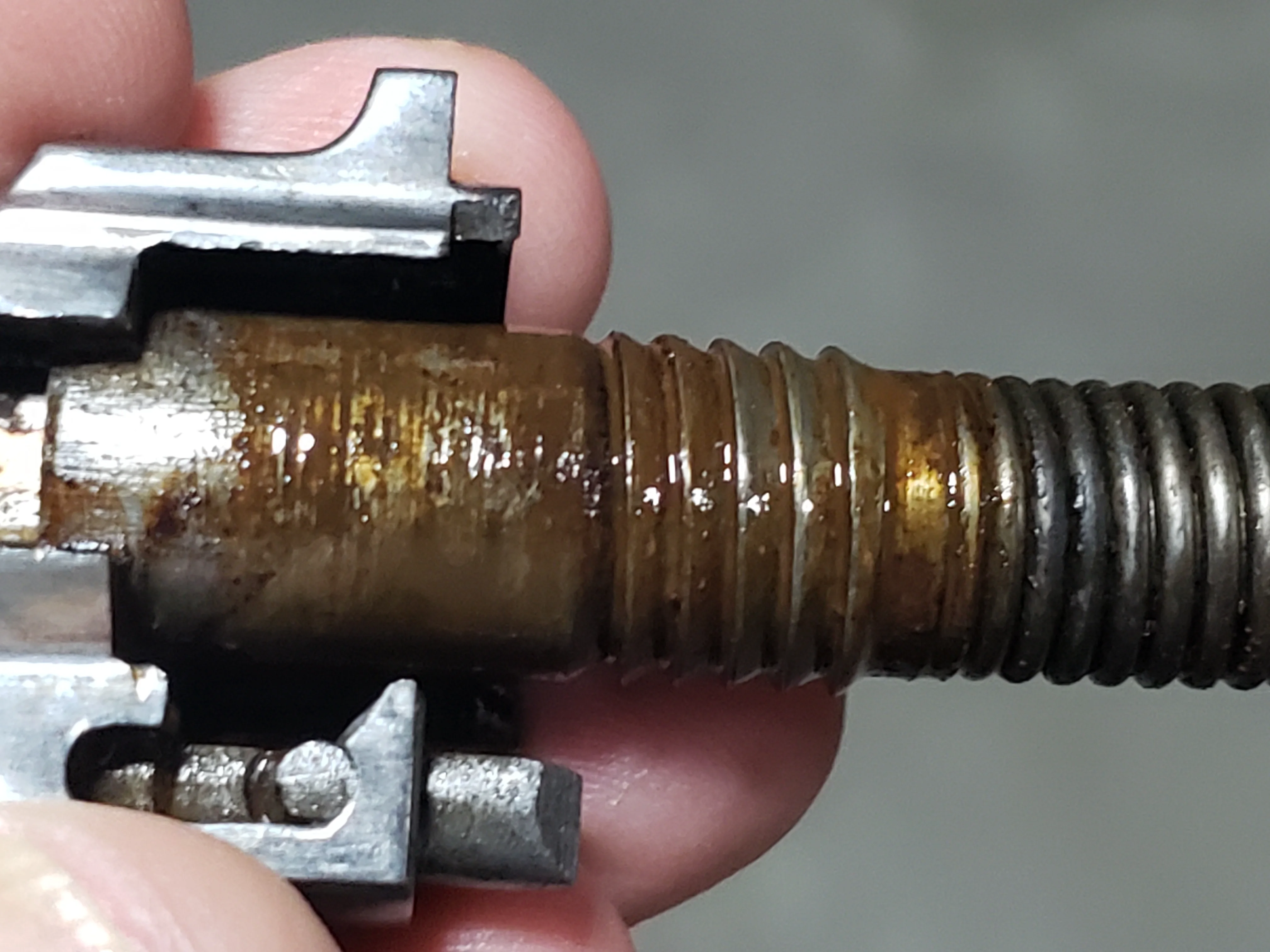

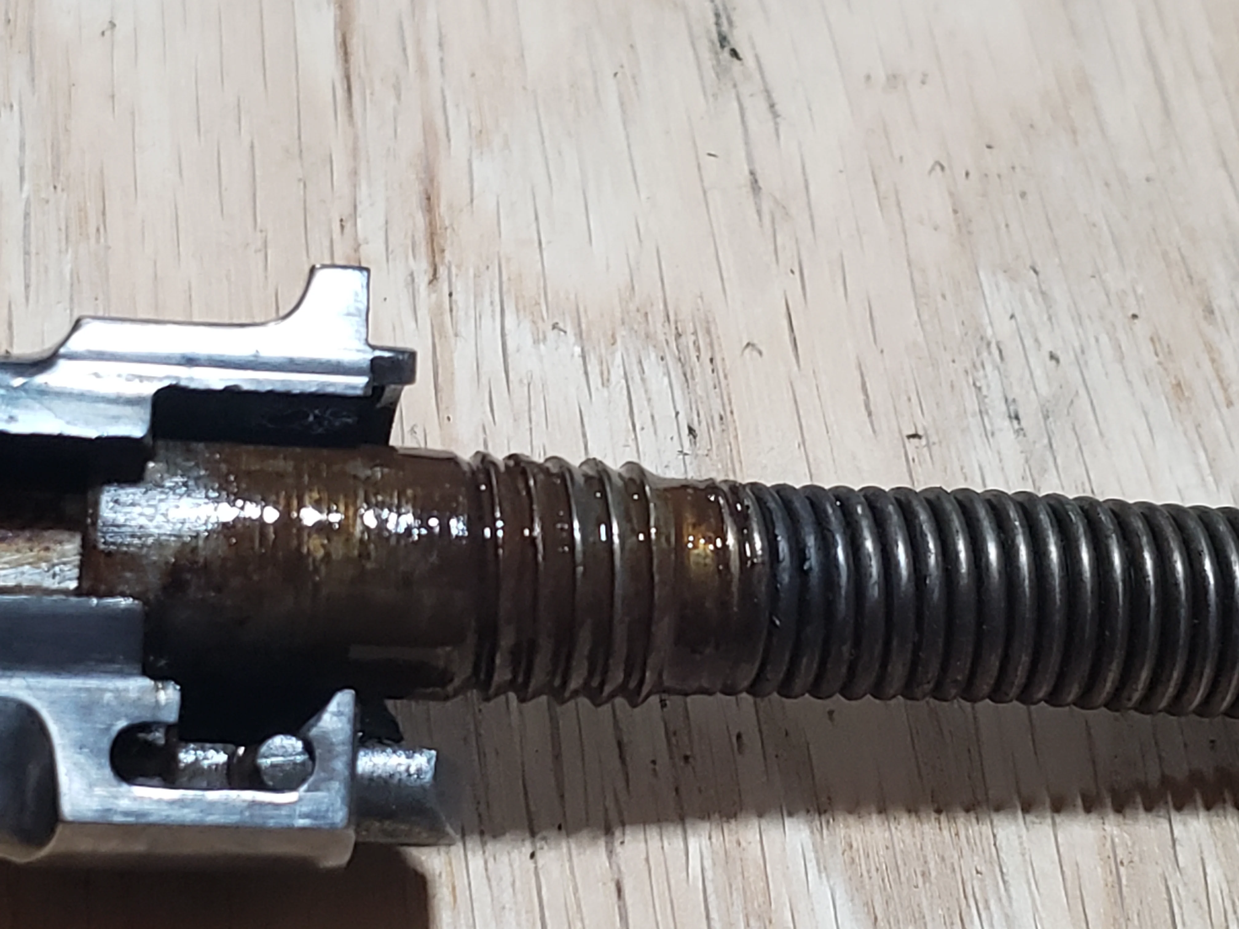

Well the replacement bolt shroud arrived yesterday. Installed the spring and plunger in it, and played around fit checking everything.

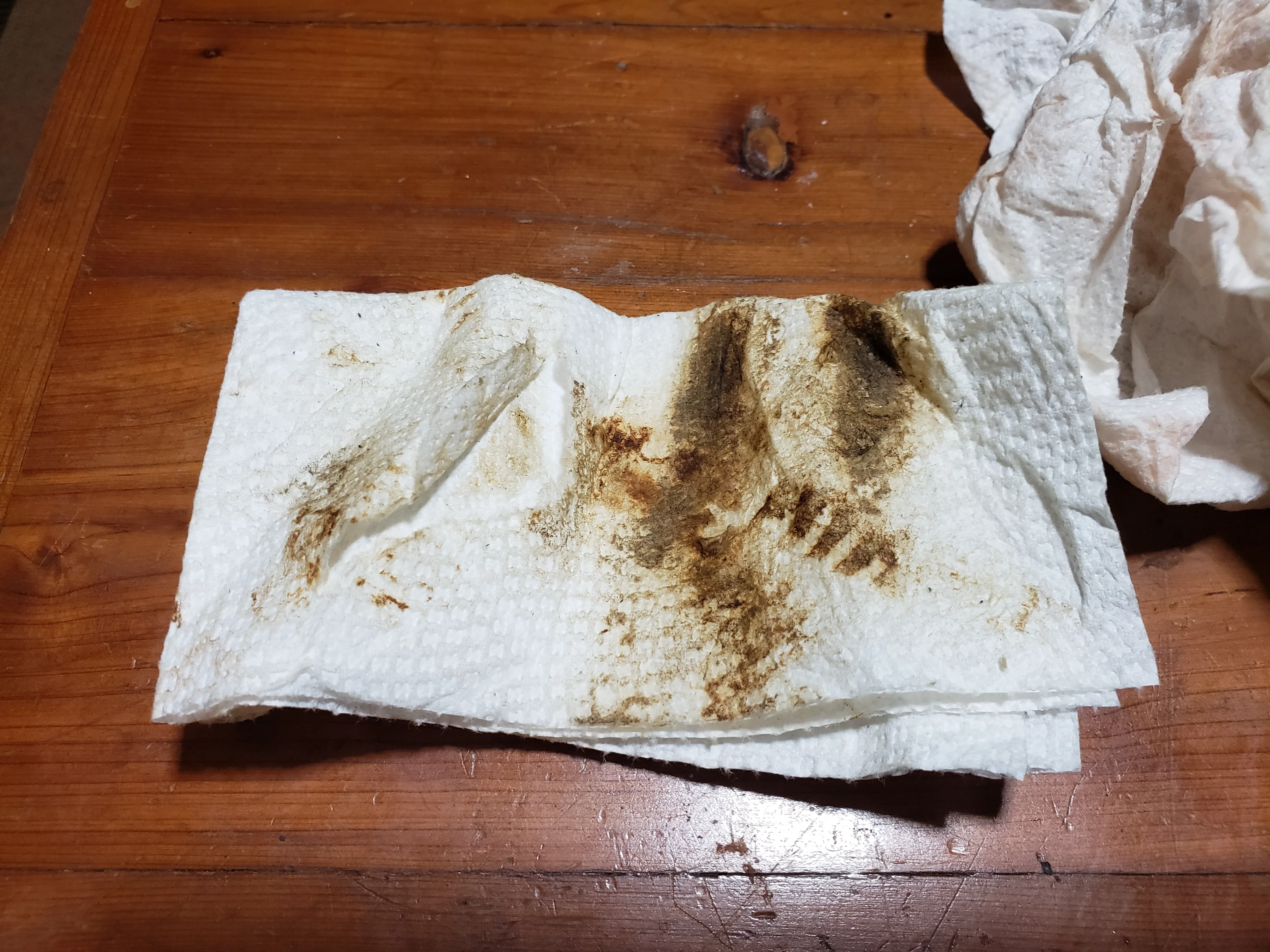

After the grandkids are picked up CINC Household and I will put the bolt back together. I was shocked at the amount of rust and sludge inside the bolt. All that has been scrubbed, cleaned, and generously oiled.
Gunk on firing pin and spring. The transmission fluid I use for oil is the reason it's wet.
Gunk from just the firing pin spring.
Old (Bottom) new (Top) bolt shrouds, it's just the angle that makes it seem they are different sizes.
I remember the BOSS the same way you stated.
Bullet weight is also a part of it.
I’m sure it would vary for every particular load. I thought it was exciting when I first read about it, but not for a hunting rifle. Maybe a bench gun. I’m sure the patent ran out and you don’t see these on bench guns do you?
I never knew it existed, until the rifle was dropped off a few weeks ago. Then I had to read up on it to get educated. Then I got scans of manuals for the rifle from Browning/Winchester. Told my daughter and SIL it'll make a good target/range gun and a good varmint gun once yall get it sighted in. I'll have to post up some pictures of it, haven't done anything to or with it yet.
