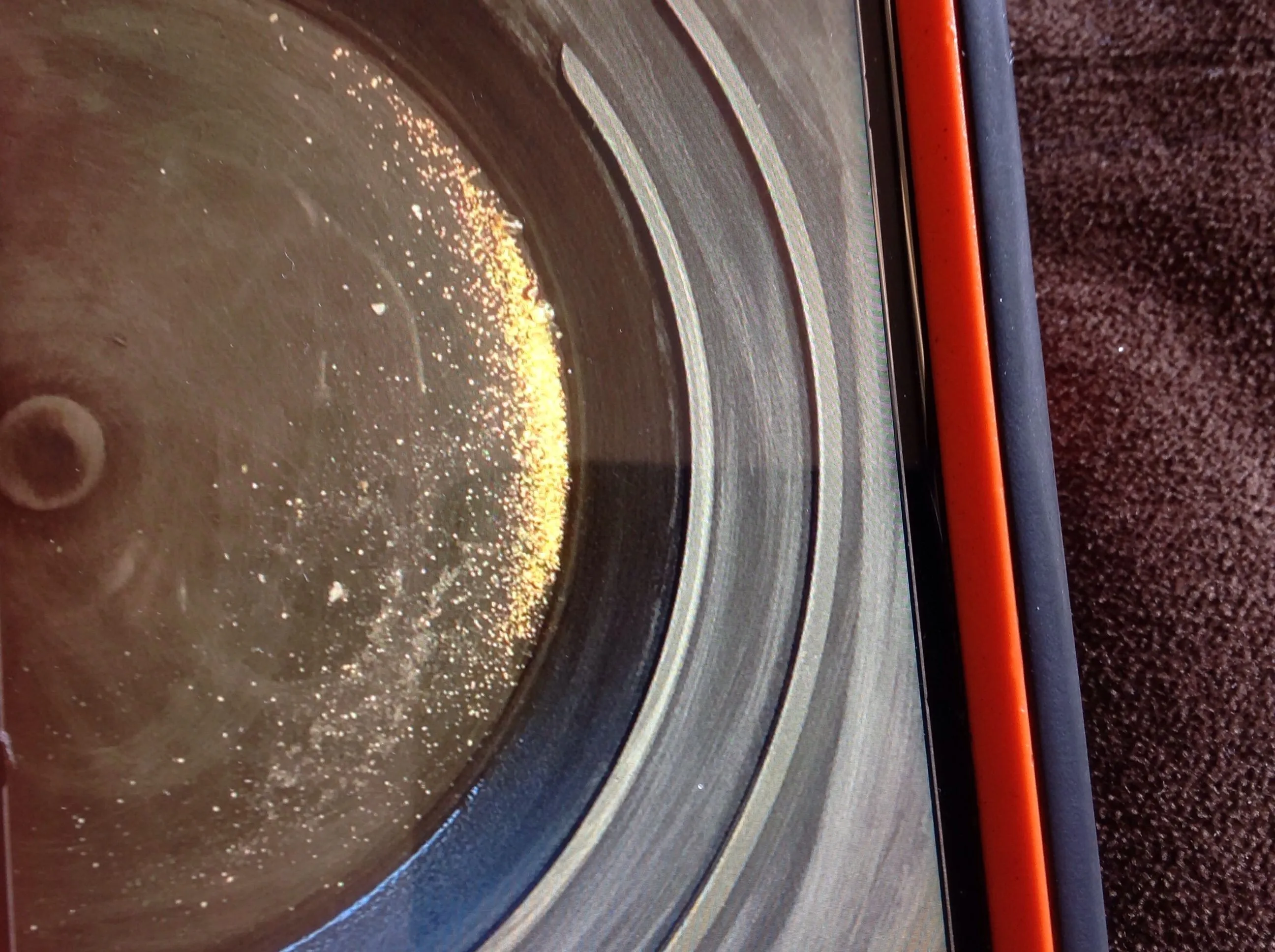

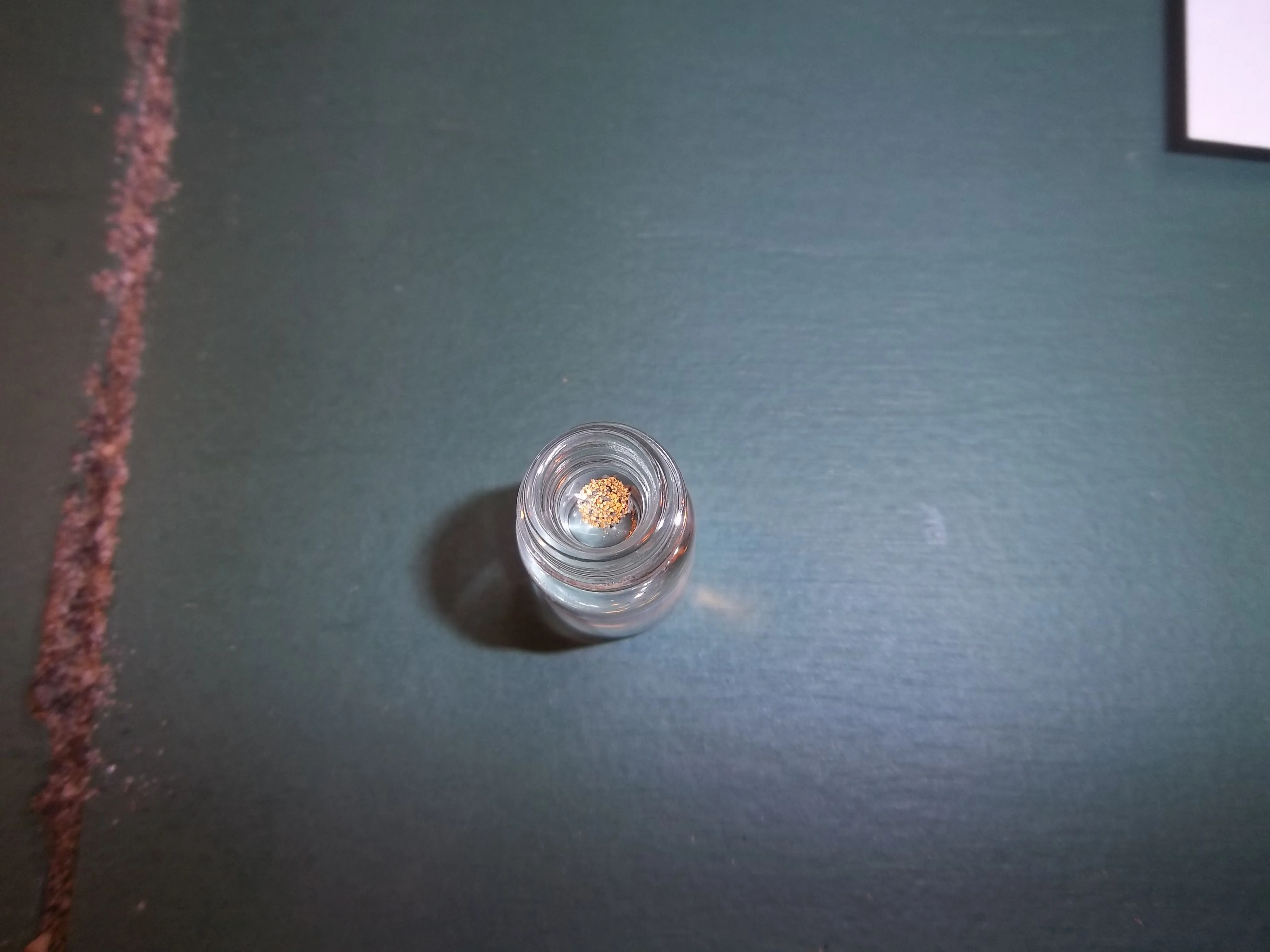

Anybody out there have any experience with the dream mat in the gold cube for super fine gold? 100 to 300 mesh. I do a lot of prospecting on the Missouri River the between the mouth of the Mississippi River and Washington Missouri. I just recently found a weird gravel bar that is full of very large glacier till garnets and black sands' some as large as basketballs. All my test pans on this very small bar' about 4000 sq feet. Had 20 plus colors. All other gravel bars I am lucky to get speck or two per pan. I went back and ran 20 half full 5 gal buckets' with my 5 stack cube with the tromel. The pictures is what I found. I know a lot of gold is blowing out of the cube. I panned the tailings. I am wanting try the micro and mini Dream mat in the cube. If any body has any ideas on this' or other ways to catch this super fine gold? It would be greatly appreciated.
