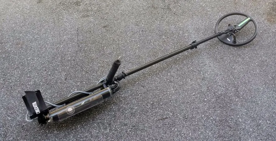

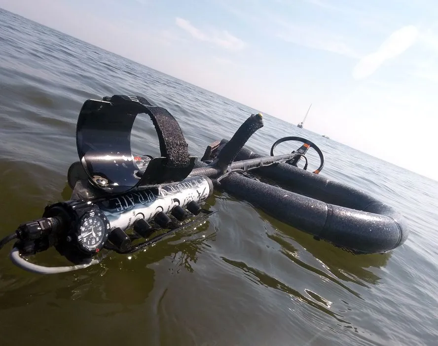

No it does not matter, unless your going with a very long cable. Sorry I missed this, hope I'm not to late. As you can see, no performance changes with my machine and I run 2 of mine as short as possible.
Also I had asked Eric Foster about this, he said only difference would be if you ran a very long cable would the performance suffer. He said running a short cable would not increase performance because the difference between stock and shorter, being only a few feet was not enough to change anything.

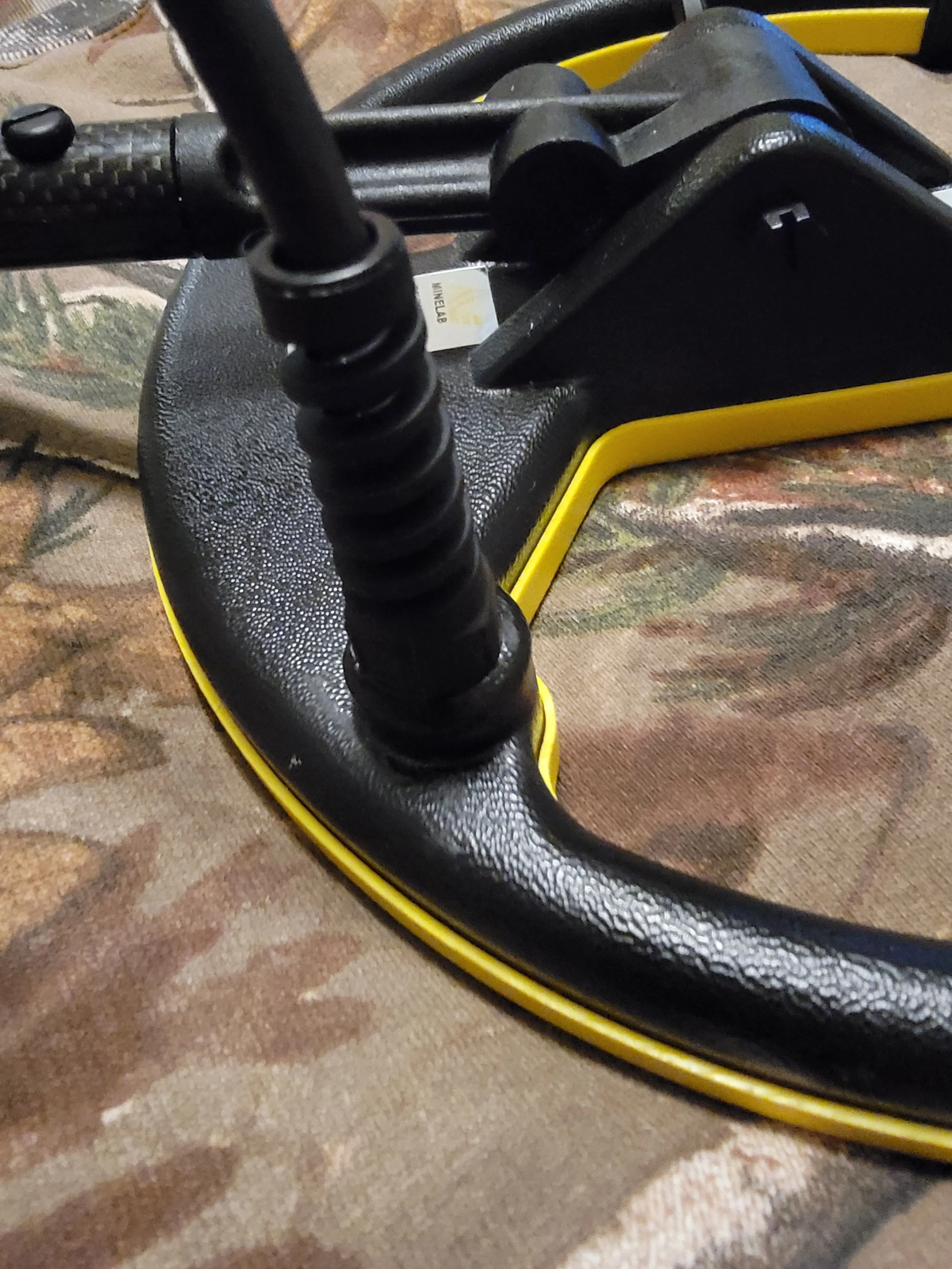

Nope - you were not too late. My machine is currently with Tony E. in California undergoing repair. I went with a much shorter cable length after reviewing some of your past comments on the subject and after consulting with Tony.

Got my detector back from Tony. It is "like it never even happened." Looks stock and the coil cable is now six feet long. Tony does incredible work.
